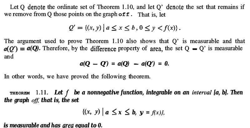

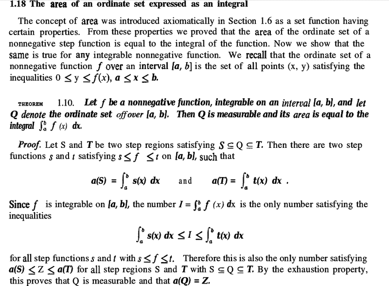

In section 1.18 ("The area of an ordinate set expressed as an integral"), Apostol proves two theorems. the first, theorem 1.10, deals with the area of a function's ordinate set; the second, theorem 1.11, deals with the area of the graph of the function of theorem 1.10. (I have attached two excrepts from Apostol's book, one per theorem.)
I am having problems understansing Apostol's logic in theorem 1.11 where he states:
"The argument used to prove Theorem 1.10 also shows that Q’ is measurable and that a(Q’) = a(Q)."
I don see how he could argue this, being that ##Q'=\{(x,y)|a \le x \le b, 0 \le y < f(x) \}## which implies that ##S \subseteq Q'## is not true for all step regions S (since S may contain a point of the graph of ##f(x)## which Q', by definition, can't).
Thanks in advanced for any help.

I think the method is the same, but the definition of S would have to change if a point in S was equal to f(x).
So for the measure of Q', you would have sets S' and T', but the result would be the same--that the area of a line (or curve) is zero.
You can make the points ##(x, y)## in the set ##Q'## sufficiently close to the graph of ##y = f(x)##. So the areas are indeed equal.
RUber, I see what you're saying, however the new step regions (S' and T') would produce functions bearing the following relationship with the function##f(x)##: ##s'(x) < f(x) \le t'(x)##. Which doesn't help since the definition of the integral requires "##\le##" for both step function inequalities.
Zondrina, The idea is making the of make the points equal since by definition of Q': ##Q \neq Q'##. So no matter how close I get too the points of ##f(x)##, I would not be able to put all points of both regions in a one-to-one correspondence in order to then argue by congruence of regions.
You can define a sequence s_n(x) such that the limit as n goes to infinity of s_n(x) = f(x). In this way, you will still satisfy the requirement that the intervals will converge on the true integral.
I get what you're saying. The only problem is that Apostol still hasn't mentioned sequences. The only relevant thing I can think of that has been covered in the book till now is the Least Upper Bound Property of Numbers. Which would simply state that ##f(x)## is the supremum for ##Q'##
