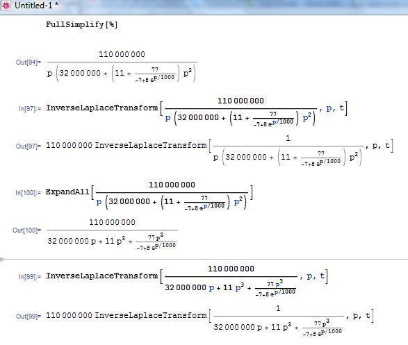

Hi!
Now i have one new problem, i can't run this Laplace equation (see attachement)
I don't know what to do, sorry... please help me!
Thanks!
See the "InverseLaplaceTransform" don't show me the answer... why?

When I made my reply, I was keying in on your desire to plot, which doesn't require manipulating things into a "nice" form. I was hoping that if you were less interested in plotting and more interested in "simplifying things" or "expand a function"... or that it would prompt you to look up the keywords "simplify" or "expand" in the help.
Have you looked through Mathematica's documentation center? (e.g. under the "help" menu, or by hitting F1 after highlighting a word) It's pretty good. I didn't know about ComplexExpand myself, but I expect it's not hard to find if you started with the page for Expand or Simplify. I think there's even an article on "simplifying functions" but it's been a while since I looked at it.
