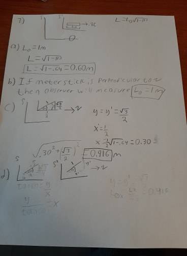

7. A meter stick is moving with speed 0.8c relative to a frame S .
(a) What is the stick’s length, as measured by observers in S , if the stick is parallel
to its velocity v ?
(b) What if the stick is perpendicular to v ?
(c) What if the stick is at  60 to v , as seen in the stick’s rest frame? [Hint: You can
imagine that the meter stick is the hypotenuse of a 30-60-90 right triangle]
(d) What if the stick is at  60 to v , as measured in S ?
I believe i have solved a-c , but cant figure out d, looking suggestions?
L=Lo*sqrt (1-β^2)
told to use this equation and not lorentz transformation for this problem
...cant figure out d, looking suggestions?
There are different ways to solve this. One approach is to first find the value of ##\theta '## (the angle that the stick makes to the x'-axis in the primed frame). A hint for doing that is to consider how ##\tan \theta'## is related to ##\tan 60^o##.
