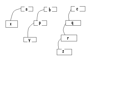

Oh, I didn't realize the question left out the other variables. The problem has a diagram that I can't include, so I left out the part of the question that says it wants the program to mimic the diagram. It shows z > r > q > c
Which means z is pointing to r which is pointing to q which is pointing to c.
It also has y > b > p and x > a.

What you have looks good, except for the last line. You're almost where you need to be, with all of your variables initialized correctly.
Now all you need to do is multiply a and b, and store the result in c. To get the values of a, b, and c, you need to use pointer dereferencing.
For a: Dereference x, as in *x.
For b: Dereference y twice, as in **y.
For c: Dereference z three times, as in ***z.
To see how this is working for a, suppose that a's value is 5 and that it is stored at location 100. After all variables are initialized, the value of x will be 100, and *x will be the value at location 100. Note that I am make these addresses up, but what I'm describing is the way things actually work.
IOW, x == 100 and *x == 5
To see how it's working for b, suppose that b's value is 15, and that it is stored at location 104. Suppose that p is stored at location 120. After initialization, we would see this:
y == 120
p == 104
b == 15
*y == 104, the value stored at p's location
**y == 15
Using similar analysis you can use z to get the value stored at c's location.

OK, the multiplication is a bit more complicated than I described. In my notes I neglect to write down the part where it say to store the product in c using x, y, and z.
Instead of doing c = a * b, you need to do this:
Code:
***z = *x + **y;
This is all too complicated to try to keep in your head, so in my notes I have drawn a diagram that shows the relationships between all of the variables. Along the top I have three boxes labeled a, b, and c.
Another box is labeled x, and has an arrow that points to a's box.
Two more boxes are labeled y and p. There's an arrow from the y box to the p box, and another arrow from the p box to the b box.
I also have boxes for z, r, and q, with arrows pointing to the appropriate locations.
The problem with your code is that you are trying to multiply things (addresses) for which multiplication is not defined. The only operations that are defined for pointers are increment, decrement, addition, and subtraction, and of course, dereferencing.
&x is the address of x, which is irrelevant here
&p is the address of p, which is what happens to be stored in y, but is no use if you're trying to get the value in b.

You're not adding x and y. That's not what *x + **y means.
Here's a sketch of the drawing I did. It helps me keep things straight.
x == the address of a
*x == the value stored at a
y == the address of p
*y == the value stored at p (another address)
**y == the value stored at b
By dereferencing y once we get the address stored at p. By dereferencing y again, we get the value stored at the address p points to. IOW, we get the value stored at b.

Oh, I put in the code and typed in two numbers and it added the two numbers that I entered.
Yeah, that's what mine looks like, except it's upside down.

Either of the first two would be fine, except they don't satisfy the requirement of using y. For this requirement you need an expression with y in it that evaluates to the address of b. Think about what I said before about the value that is stored in a pointer variable.
I'm not sure if I did what you asked, but here's the code of what I changed.
I made **y = p
And then made return a*b;
Code:
#include <stdio.h>
#include <stdlib.h>
int main()
   int c;
   int b;
   int a;
   int* x = &a;
   int* p = &b;
   int** y = p;
   int* q = &c;
   int** r = &q;
   int*** z = &r;
    printf("Enter a value for a: \n");
    scanf("%d", x);
    printf("Enter a value for b: \n");
    scanf("%d", y);    return a*b;
Were you wanting me to get the memory address of b using y?
Just a short twit:
According to this forum's guidelines requests for homework or self-study assistance should be post in the Homework & Coursework Questions area.
Regards
gsal
Oh, I'll remember that for next time. Thanks. I posted a few physics homework questions there, I don't know why I didn't think about putting this there too.
These two lines aren't right.
Code:
scanf("%d", y);
return a*b;
In the call to scanf, a value that you enter is stored at the location that y is the address of, namely p. That's not what you want. This needs to be an expression that involves y.
What expression with y in it evaluates to the address of b? Look at the picture.
In your return statement, the basic problem requirements are not met.
Finally, it prints all three variables using the pointers x, y, and z.
So returning a * b doesn't meet the requirements. There should be one or more calls to printf inside main to print expressions involving x, y, and z.
Also, having main return the value means that you won't see the returned value, since main returns control to the operating system. main should return 0.
Code:
scanf("%d", y);
return a*b;
Is this correct?
Code:
    scanf("%d", x);
    scanf("%d", **y);    return 0;
If so, I had it like that before, but for some reason my program kept crashing every time I ran it, so I changed it, thinking the ** in the scanf statement was causing it. But now it's not crashing.
Edit: But now I just realized that **y is the value of b, not the memory address, right? I can't figure out how I would get the address of b without using p.
No, **y is not the right expression in scanf, as you know.
As you also know, the value in p is the address you need. What other expression that involves y also contains this address? It's not a very complicated expression.
Is it &*y?
I did a printf("%d", &b)
And a printf("%d", &*y)
And I got back the same answer.
You don't need the & operator - *y already is an address.
I think I got it. Does this look right?
Code:
#include <stdio.h>
#include <stdlib.h>
int main()
   int c;
   int b;
   int a;
   int* x = &a;
   int* p = &b;
   int** y = p;
   int* q = &c;
   int** r = &q;
   int*** z = &r;    printf("Enter a value for A: ");
    scanf("%d", x);
    printf("Enter a value for B: ");
    scanf("%d", *y);
    *z = *x * **y;
    printf("A * B = %d\n", *z);
    printf("C = %d\nA = %d\nB = %d", *z, *x, **y);
    return 0;
The problem requirements are satisfied now. Does it give the right results?
