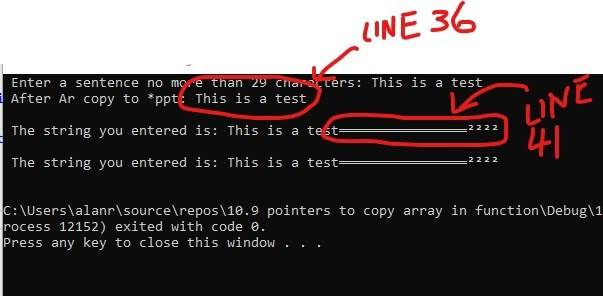

Hi
I wrote a program to copy an array of C-String into dynamic memory in the function using pointers. I think I did it right, but I cannot display without garbage at the end of the string.
As shown, I display at line 36 and you can see it is correct, it jump out of the while loop after completing the whole sentence and it is correct, no garbage.
But when I display using while loop in line 41 using the same logic to stop when '\0' is encountered, I got garbage as shown after the "This is a test". the same issue happens when return back to the main.
I don't see anything wrong, please help,

I actually spent a few hours going back and fore looking at the program and test before I posted late last night. I looked at it again today, I still cannot see why it's different.
As I said, I display the array in line 36, it is CORRECT, exactly what it is expected. But in line 41, the while loop cannot detect the '\0' until much later, thereby spitting out garbage.
Today, I even display the content of array pointed by pptc right when entering the function to make sure I have the '\0' at the end of the string and display line by line. It is correct. Meaning I passed the pointer correctly, display the array pointed to correctly.
As you see, the string "This is a test" was copied from *(Ar + index) = *(*pptc + index) correctly, just somehow after getting out of the while loop, the '\0' cannot be detected in line 41.

I found it, it's not even in the way I did it. It's line 41 *(*pptc + index) = '\0'; to put the NULL after the last character. it should be *(Ar+ index) = '\0'; as it's the one that will be sent back. It's is just a simple line to add a terminator to the c-string and I put it in the wrong string.
