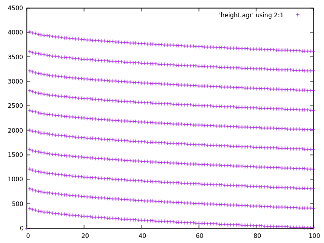

I am trying to solve the following first order ODE using a simple Fortran code :
$$ ds/dt=k_i * \sqrt{v}$$
where both (ki) and (v) are variables depending on (h) as follows
$$ k_i=\sqrt{χ/h^2}$$
$$v= \mu h$$
where (μ) and (χ) are constants. (the arbitrary values of each of them can be seen from the code attached).
Note: h changes from 100 to 1 with -1 reduction
Now after writing the code, I would like to plot (s) as a function of (h). but what I will get is not a single plot, but a series of plots depending on the number of timesteps. the issue has to do with loops, but I am not sure how to get a single plot of (s) against (h) as it grows over a period of time.

Your write statement is in an inner loop, so you get 100 writes for every time step.
What's worse, s is incremented 100 times for every time step too.
And the outer loop is done only 10 times.
What is it you want to do ?

Thank you very much for your answer
I am trying to follow the change of s as a function of time and h, then plot s vs h.
for example: if s is a strength of a material, while h is height (from 100 to 1cm), I would like to plot s vs h for 100 years time.
Kind regards,
Joseph
My guess is you want to swap the loops and reset t to 0 in the outer loop. That way you get s(t) with h as a parameter.
And I'd do 100 steps in t and 10 steps in h.
