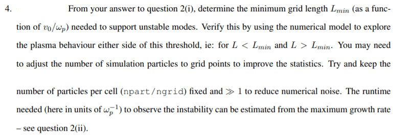

Summary:: I am learning particle-in-cell (PIC) python 3X code. PIC currently represents one of the most important plasma simulation tools. It is particularly suited to the study of kinetic or non-Maxwellian effects.
I am learning particle-in-cell (PIC) python code. PIC currently represents one of the most important plasma simulation tools. It is particularly suited to the study of kinetic or non-Maxwellian effects.

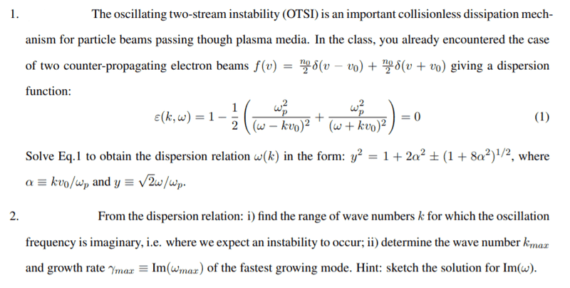

Given the following dispersion relation
$$\epsilon (k, \omega) = 1 - \frac 1 2 \left[ \frac{\omega_p^2}{(\omega-kv_0)^2} + \frac{\omega_p^2}{(\omega+kv_0)^2}\right]$$
I found the range of wave numbers $k$ for which the oscillation frequency is imaginary to be ##-\left|\frac{w}{v_0}\right| \lt k \lt \left|\frac{w}{v_0}\right|##
What I am trying to understand is how to find the minimum grid length ##L_{min}## as a function of ##\frac{v_0}{w}##. ##L_{min}## indicates the needed minimum grid length to support such unstable modes.
I think we should be able to study the plasma behaviour for both ##L < L_{min}## and ##L > L_{min}##. I was told I should adjust the number of simulation particles to grid points to improve the statistics. Besides, the number of particles per cell (i.e. npart/ngrid) should be fixed and should be much greater than 1, in order to reduce numerical noise. The runtime needed (here in units of ##\omega_p^−1##) to observe the instability can be estimated from the maximum growth rate.
Here's the full python 3 code I am working with. Please note I have little experience with coding so I might ask lots of follow up questions.

Let me summarize my question, given that it might be uncomfortable to be presented with such a long post.
I am interested in finding the minimum grid length ##L_{min}## needed to support unstable modes. To do so the code should be checked in order to understand the plasma behavior either side of ##L_{min}## threshold, ie ##L_{min} < L## and ##L < L_{min}##.
I am given the following hints
  • Adjust the number of simulation particles to grid points to improve the statistics.
  • Fix the number of particles per cell (i.e. npart/ngrid) and keep it ##>> 1##, in order to reduce numerical noise.
  • The runtime needed to observe the instability can be estimated from the maximum growth rate.
If you guys could guide me through I would really appreciate it :smile:
You might point out I should deal with some issues first, such as where we expect an instability to occur given the dispersion relation (in other words, finding the range of wave numbers ##k## for which the oscillation frequency is imaginary). If you need me to address that first let me know and I will deal with such smaller question in a different forum :)

Let me share the original statement
So question 2 should be solved first; let me share that question's statement too (together with 1's, given that 1 and 2 are related)
I have been dealing with question 2 for days and this is what I got.
If you see it is really unavoidable to properly solve 2. first let me know and I will ask it in PF this time :smile:
JD_PM said:
I have been dealing with question 2 for days.
Then you have been wasting your time, as well as that of stackexchange members.
Didn't you notice the ## = 0 ## at the end of ref ## (1) ##, or did you think it was unimportant? And in any case why are you trying to use the dispersion function ## \varepsilon (k, \omega) = 0 ## given in question 1 to find unstable values of ## k ##? Question 2 states that you should be using the dispersion relation derived as the answer in question 1.
OK, we are dealing with #2 here.
You are right, thanks for pointing it out! I used the dispersion relation (as can be checked in the other thread) and obtained the following range
$$-\left| \frac{\omega_p}{v_0}\right| < k < \left| \frac{\omega_p}{v_0}\right|$$
The corresponding range for ##\alpha## is ##-1 < \alpha < 1##.
We want to relate the wave number ##k## to a (minimum grid) length. We know that the wavelength ##\lambda## relates to the wave number ##k##
$$\lambda = \frac{2 \pi}{k}$$
So assuming that with "grid length" they meant "wavelength associated to the wave number ##k##", then the minimum grid length should be
$$L_{min} > 2 \pi \left| \frac{v_0}{\omega_p}\right|$$
So that we can actually see the grid.
OK but now the question is how to implement this into the code.
