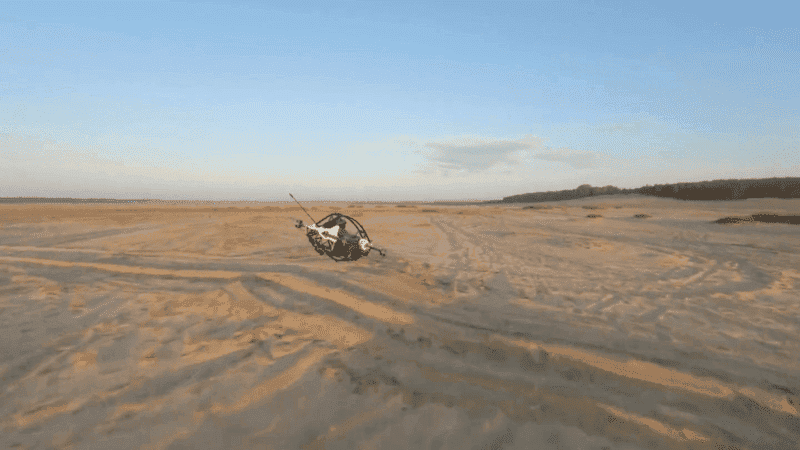

Much safer to get a ride on one of these personal drone aircraft...
https://www.jetsonaero.com/

I appreciate the help but that definatly can't lift 300 pounds let alone 20lb

Will you be electric or jet fuel powered? Frenchman Franky Zapata's Flyboard lifts ~200 lbs with 5 model jet engines. A rough back or the envelope calculation based on a 45 lb thrust engines each consuming 0.55 L/min with an energy density of 44.6 MJ/kg gives about 2500HP but probably 80% of that power is waste heat.
The Jetson machine above quotes a max power of only 88kW which is ~100HP.
