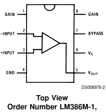

I think maybe, i soldeer it one more lm386 WITH bypass capacitor at pin 2 and 6, and also i change the battery little bit old,
and also i can hear nothing from earphony, totally nothing,
That should be pin 4 and 6.
Do you have any test equipment besides the voltmeter?
how not, how i measure til now?, but in the book is between pin 2 and 6 capacitor, how come now pin 4 and 6(are you sure)?
i have dvm
michael1978 said:
how not, how i measure til now?, but in the book is pin 2 and 6, how come now pin 4 and 6(are you sure)?
The image below is from the datasheet for the LM386 made by National Semiconductor. As you can see, the supply voltage is on pin 6, Ground is pin 4, and -Input is pin 2. Your circuit has pin 2 connected to Ground, probably as a short circuit trace between pins 2 and 4. I said pin 4 for the bypass capacitor just to be very safe (conservative). If there is a bad connection on the board between pins 2 and 4, the bypass might not connect to Ground if soldered to pin 2.
If the connection between pins 2 and 4 are good, for your circuit it probably will not make much difference. For other circuits it can make a difference, so we all get in the habit of connecting bypass capacitors to the power and Ground pins just to avoid problems.
