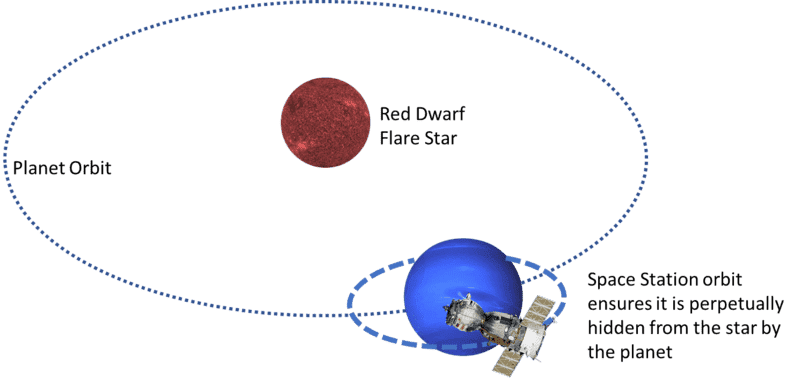

So, I think it's possible to place an object in an orbit such that it remains perpetually in the planet's shadow, like in my awesome graphical representation. But is it?
That's a really delicate question. Although orbits with several day period should exists (in match with the usual period for the planet orbiting its red dwarf sun), I think these would be with really high radius and I'm not sure that at that distance the planet would be able to provide significant protection against charged particles of those flares. Especially since the magnetic field of a (habitable?) planet is supposed to give those particles some twist.
Thanks, @Rive, I wondered if it would highly situational, with attributes such as planet size, distance to star, how active the star is, etc., making any answer a strong, "maybe, but..."
I might use the concept incidentally, but won't make it a common method of protecting habitats from flare stars.

Yes, this is possible if you place the object in the L2 Lagrange point. However, depending on the masses and sizes of the involved bodies, L2 may lie in the umbra or antumbra. If it is the latter, then it will not be perfectly shadowed as, seen from the Lagrange point, the star will cover a larger part of the sky than the planet. For the Sun-Earth system, it is a borderline case if I recall correctly.
This is where the James Webb telescope is placed for precisely this reason.
Also note that the L2 Lagrange point is unstable. In order to maintain the orbit you will need to regularly correct it.

It sounded like Melbourne Guy was describing something different then a Lagrange point. This idea can only work for planets that orbit very close to their stars. If a planet orbits its star in five days, and the station orbits the planet in five days, then the orbit could be timed such that the planet was always between the sun and the station. (Or indeed at any other angle desired.)
No, by definition of the description in the OP, what is required is a point that is stationary in the corotating frame of the star-planet system and that by definition is a Lagrange point.

I'm going to have to work out a Lagrange point and see if it fits, because my initial understanding is not enough to confirm (or deny) @Algr's observation. Certainly, I want the station hidden from the star at all times, but as an orbit, not having to continually fire the thrusters.
The Lagrange point didn't require continuously firing your thrusters. You just have to occasionally reposition yourself, because if you are too close to the planet you fall towards the planet, and if you are not close enough to the planet you will drift further out into space. The actual net gravitational pull is 0 if you exaaaactly nail the point, but for actual practical placement, is very very close to 0. The Webb telescope for example, in its final thruster firing for insertion, turned its thrusters on for five minutes.The telescope also hasa disadvantage, which is that it only has thrusters on one side, so has to intentionally stay closer to the planet. If you have thrusters on both sides you can stay closer to the middle and use less fuel. If you're putting up a habitat that people are permanently living in, it doesn't seem like a stretch that they could have enough fuel to maintain position for a hundred years without refueling (the Webb telescope has enough fuel for twenty years based on how efficient its initial insertion was)
Since the planet would be tidally locked, the orbit Melbourne Guy is describing would also be a geosynchronous orbit.
There is nothing to confirm. For any two body system in circular orbit, there are exactly five stationary points for a test particle in the corotating frame, which your setup would require it to be. These stationary points are the Lagrange points L1-L5 and out of those only L2 satisfies your requirement of having the lighter of the two bodies in between the larger and the Lagrange point. There simply are no other such solutions.
