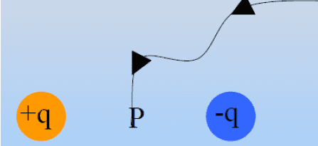

what will be the convention of work done in moving a positive test charge from infinity to the point p midway between two charges of magnitude +q and -q.
As the work done by the field zero, it does not make much sense to talk about its sign, does it?
