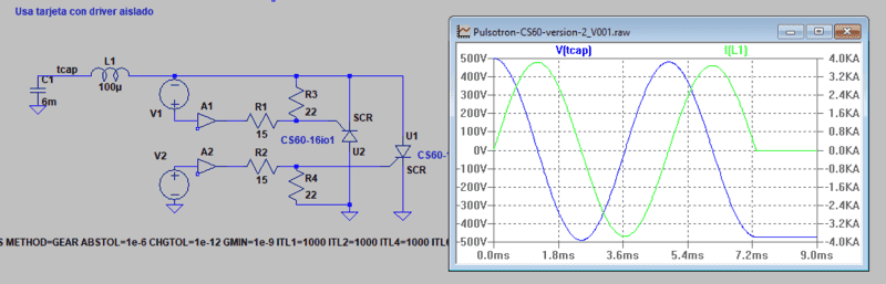

I have made following design to drive two high power hokeypuck SCRs to activate a Plasma compression coil. As long as catode falls below 0V, I do not know if it is needed to insert diodes from the optoisolated driver A1 (and A2) and the limiting current resistor R1 (and R2):
  • LTspice schematic of an isolated SCR gate driver: capacitor C1 and inductor L1 feed two SCRs, U1 and U2, each driven by a source V1 or V2 through amplifiers A1 or A2, resistors R1 and R2 at 15, and R3 and R4 at 22.

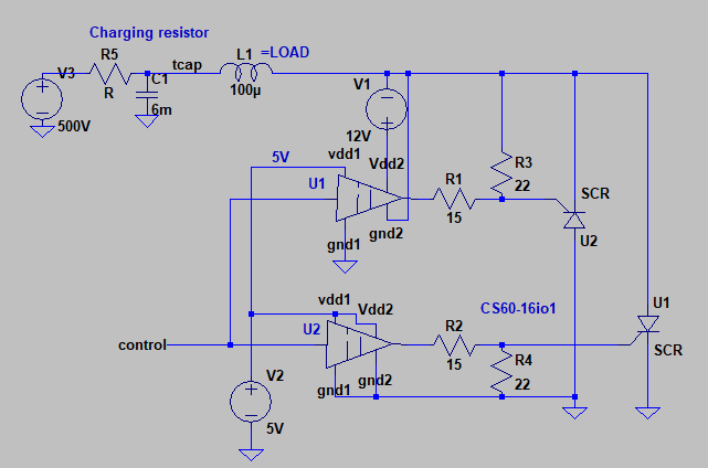

Where exactly would you insert those diodes? And can you show the full circuit for the gate drive circuits?
Here is the complete drawing. U1 and U2 are isolated drivers. I ask if I have to insert a diode between U1 and R1 and another between U2 and R2 (in the forward resistor direction). (The R3 and R4 are set to drain the inducted voltage due high dV/dt at SCR due >10kAmps are drain).
My idea is to charge the 6mF capacitor using R5, then drain the capacitor energy through the coil sorrounding the plasma that is L1 by using a trigger signal named "control". As long as L1 is a superconducting inductor, most of the current will come back to the capacitor then I will switch off the device :)
Circuit schematic: 500V source with charging resistor R5 feeding capacitor C1 (6m) and inductor L1 (100u), with a 12V supply V1 and SCR U1 on the output. Two isolated drivers U1 and U2 with 5V supply V2 drive SCR U2 through 15 ohm resistors R1 and R2, each with a 22 ohm resistor R3 and R4 across the SCR gate.
  • Circuit schematic: 500V source with charging resistor R5 feeding capacitor C1 (6m) and inductor L1 (100u), with a 12V supply V1 and SCR U1 on the output. Two isolated drivers U1 and U2 with 5V supply V2 drive SCR U2 through 15 ohm resistors R1 and R2, each with a 22 ohm resistor R3 and R4 across the SCR gate.
