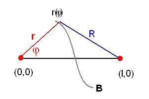

Show a figure please.
ehild

Show the figure please. How does the curve B look like? You need the equation of the curve for the solution.
ehild
Isn't the equation of the curve the thing you are meant to solve for?
Oh sorry, I have not read the whole problem, just missed a figure to understand the problem.
Those two square roots are scary. Try to do it in polar coordinates. You get R with the Cosine Law, and then solve the equation n1R+n2r=n1(L-f0)+n2f0 for r in terms of φ.

The problem is, I am not allowed to introduce more variables (i.e. no radius of curvature or angles). I must solve using the variables given. I wonder if there is a simpler way to represent x and y in a function. This is a POPTOR question by the way, but the deadline is past, so you guys don't have to worry about violating any rules. Just wanted to know if I did it correctly.
Your equation is correct, it is only terrible to solve it that way. It would mean moving one square root to the other side, then squaring the whole equation, then isolating the remaining square root, and squaring the equation again.
When using polar coordinates, you represent x by x=r cos(phi) and y by y=r sin(phi). They are just notations, to make the solution easier. If you get the function r(phi) you can transform back to x and y. But it is still a very complicated thing.
I could not find any simpler method. Anyway, your equation is an implicit definition of y(x) if you replace y by y(x).:wink:
I outline the solution in terms of r and phi.
n_2r +n_1R=n_1(L-f_0)+n_2f_0
R^2=r^2+L^2-2rRcos(\phi)
Isolate R from the first eq.
R=L+(n_2/n_1-1)f_0- n_2/n_1r
Introduce the notations n2/n1=n (it is the refractive index of medium 2 with respect to medium 1) and L+(n_2/n_1-1)f_0=A, and substitute for R into the second equation
(A-nr)^2=L^2+r^2-2rLcos(\phi).
It is quadratic for r.
r^2(n^2-1)-2r(An-Lcos(\phi)+(A^2-L^2)=0

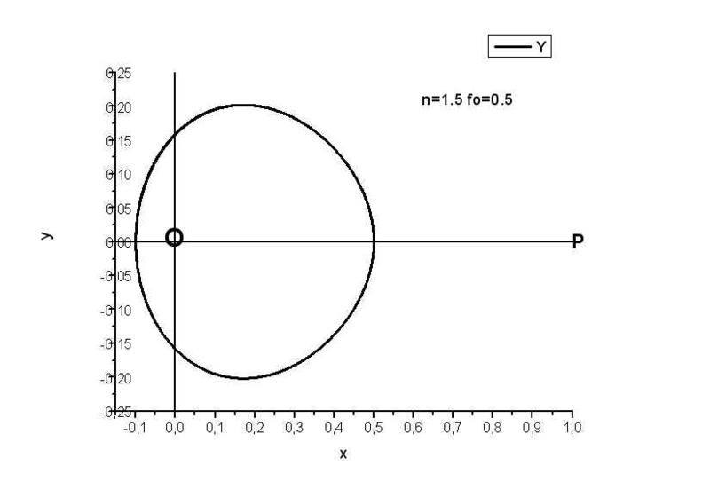

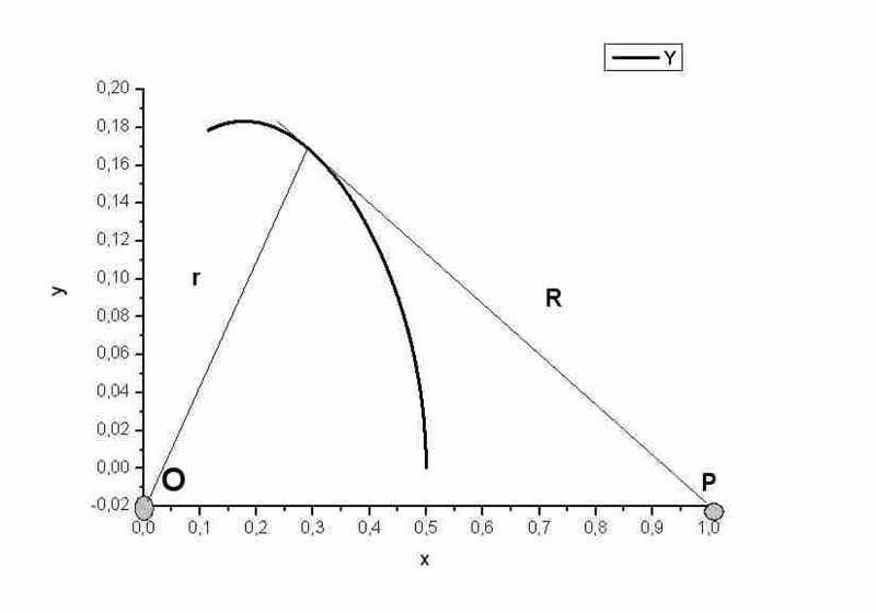

I calculated the curve for n=1.4, L=1, fo=0.5.
