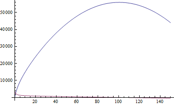

I'm no Mathematica expert, but you should be able to solve it using NDSolve.
Plugging the equations straight in (with a small change to make sure the drag force is always opposite the direction of movement so that the equation stay valid also when v turns negative), I get that the following inputs produces an altitude plot with a max height around 55 km:
Code:
eqs := {h''[t] == -(\[Rho]/(2 \[Beta])) Exp[-h[t]/H] h'[t] Abs[h'[t]] - g, h[0] == 0, h'[0] == v}
params := {\[Rho] -> 1.225, \[Beta] -> 3000.0, H -> 6700.0, g -> 9.8, v -> 3700}
s = NDSolve[eqs /. params, h, {t, 0, 150}]
Plot[Evaluate[{h[t], h'[t]} /. s], {t, 0, 150}, PlotStyle -> Automatic]
This gives the following plot:
As it is, you have to solve for each set of parameter values you want to try out. I have given it a few runs and ended up with an initial speed of 3700 m/s and a ballistic coefficient calculated from the values you gave in the first post using a drag coefficient of 0.25. I have no idea if a value of 3000 kg/m2 is too unrealistic for such a small projectile or not, though I suspect that is a bit high.
Someone with better Mathematica skills could probably make Mathematica find the initial speed that result in a given maximum height without the need for any manual bisection of values and repeated runs.
