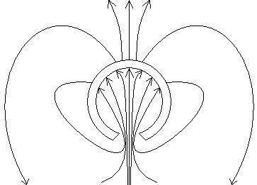

As long as the surface isn't closed, it may be possible. I would guess it would look something like the attached picture. Thoughts?

Consider theoretically constructing the sperical magnet as a series of normal bar magnets (consider 2-dimensions for simplicity). If you have two bar magnets opposite each other along the x-axis with like poles facing (N against N, or S against S). The field lines between the magnets diverges along the y-axis.
Add two more bar magnets (like poles facing) along the y-axis. Now the field lines diverge between the gaps either side of the magnets. You can probably see where this is going now...
As you increase the number of bar magnets, the field lines diverge between the gaps. Let's take this model to the infinite limit; you have an infinite number of infinitesimal bar magnets forming a sphere. The field lines would "squeeze" between the gaps, but in the infinite limit, this actually means that the field lines reverse direction entirely.
The result is that the field lines go back into the magnet and cancel themselves. Therefore the field is zero everywhere; hence no monopole!
