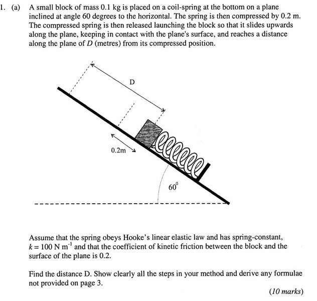

Hooke's Law on a Slope with friction.

Question is in attachment
I mananged to find the acceleration up the slope but cannot get any further than this?
- can someone please give me hint; push in the right direction
Thanks :D

Better image here
  • Diagram of a block on a 60 degree inclined plane with a coil spring at its base, compressed by 0.2 m, with distance D marked along the incline to the block's final position and the 60 degree angle to the horizontal labelled.

Solve it as a harmonic oscillator, but add a constant to the position, so that x(0)=constant. Solve for that constant, and the rest should follow.
Edit: Oh, wow, energy conservation is a lot easier. Never mind.
Mmm energy conservation i get, I am just trying to figure out the work done?
I've the force at the most compressed point, but it changes over the 0.2m it acts upon?
- what am i missing?
You can separate out the work done against friction. Kinetic energy is trivial. All that's left is to consider gravitational and spring potentials at 0 and at D.
Ok thanks for the helping hints, i'll post back if i still can't get it
- Cheers :D
