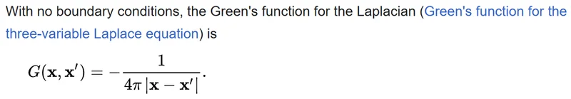

Yet using that notation is quite common when dealing with Green's functions. From https://en.wikipedia.org/wiki/Green's_function:
Text stating that with no boundary conditions the Green's function for the Laplacian is G(x, x') = -1 / (4π |x - x'|), with the link text reading Green's function for the three-variable Laplace equation.
Is there any good reason to not introduce this notation in introductory textbooks? What is sacrosanct about using (say) r vs. x?
One has to recognize that translating the world around us into mathematical equations is an unnatural act to most people. When novices are asked to do this translation in introductory courses, it is comforting to them to stick to unvarying conventions like "##x##, ##y## and ##z## always stand for position coordinates." The line has to be drawn somewhere, but it's moveable within reason as one becomes more sophisticated mathematically.
In principle, nothing is sacrosanct and one can choose any symbol for any quantity as long as one defines it properly. However, there would be utter confusion if one defines ##\mathbf P## as "Force", ##m## as "mass" and ##\mathbf v## as "acceleration" and writes Newton's second law as $$\mathbf P_{\text{net}}=m~\mathbf v.$$
