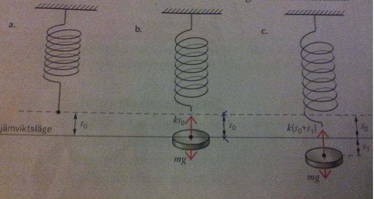

I'm having a big issue with understanding my books explanation. The image is taken from my book. The book is trying to prove the formula F = -k*y. This is the chapter ( Simple Harmonic motion)
They got the following equations(Explanation from book):
ks0 = mg
k(s0+s1) = ks0 + ks1
F = ks0 + ks1 - mg = ks1, because ks0=mg
''But the y-coordinate is negative, and equal to -s1. Also F can be written as F = -ky''
Image:
I can't understand this at all. IF I define positive direction as upwards, and negative as downwards, just like they have done I suppose, how isn't the s0 and s1 negative because the spring is obviously stretched downwards?
Shouldn't s0 be a negative value? Because for example if the starting position is 10cm, and it moves to the ''Jämviktsläge=zero level'') then it should move 0-10 = -10cm from its starting position, in other words; it's stretched -10cm?
The same with s1, if negative direction is down, then it should move -2-(0) from the resting position is this correct?
However I get totally wrong equations, unlike theirs.. I've been trying for 4 hours now..

s0 and s1 are just distances and thus positive. The displacement from equilibrium would be negative.
F = -kx
The negative means it's a restoring force.
Consider a spring which is horizontal, and a mass attached to the right side of it.
If you move it to the right (positive), the force is negative (so it points to the left)
If you move it to the left (negative) the force is positive (so it points to the right).

All they are concerned with here are the magnitudes of the forces.
The minus sign in Hooke's law just says that the spring force is always opposite to the displacement.
That's perfectly OK too. Here they are using the sign convention and the net force F equals -ky, which is an upward force since y is negative.

So I would do like I was trying to, (like in my original post, and think in the way like I did in the second post of mine..) if I wanted to figure out the directions of the forces or..? :s
Because if I understood you correctly the book has simply assumed that mg goes downwards, ks goes upwards and therefore not paid any attention to the direction of the displacement?
It seems like I've almost understood.
I think you're getting it.
The book indicates the direction of the forces by the vectors drawn in the diagram. The magnitudes of those forces are given by ks0, ks1, and mg.

You always pay attention to the direction of the forces and displacement. Your book did! That's how they knew where to draw the arrows.
If not then, when would I think like I was trying to do in my original post?
For example if I've the equation on its final form: F = -ky. If I then assume that up is equal to the positive direction, and down is equal to the negative one. If I then use the equation F = -k * 2 I would assume that the spring has stretched 2m inwards, and -2 that the spring has stretched 2m downwards?
If you want to use the equation to tell you the direction of the force, then use F = -ky. When y is negative, which is a downward displacement, then F is positive and upward. The reverse when y is positive.
When they wrote the y-coordinate is negative and equal to -s1, I assume that they then mean that the negative direction is downwards, positive upwards?
Exactly.

Again, s0 is just a distance, a magnitude. You can see from the diagram that the displacement is negative (downwards).
If the spring is displaced a distance s0 downwards, the (signed) displacement is y = -s0.
s0 and s1 are just positive numbers.

I'm not sure what you mean by 'zero-level'. Do you mean the equilibrium point, where the net force on the mass is zero?
In your diagram, s0 is the distance between the unstretched position of the spring and the equilibrium point once the mass is hung from it. When the mass is pulled down an additional distance of s1 below the equilibrium point, the spring is now stretched a total distance of s0+s1.
When the mass is released, it will oscillate up and down about the equilibrium point. It will go from a distance of s1 below equilibrium to a distance of s1 above equilibrium.

Careful: s0 is a fixed distance = mg/k.
Measuring the displacement of the spring from its unstretched position, anytime it is stretched downward you can call the displacement negative (regardless of whether it is above or below the equilibrium point). If it is compressed (displaced upward) then the displacement is positive.
Note that it is common practice, when describing the motion of a mass hanging from a spring to measure displacement from the equilibrium position.
