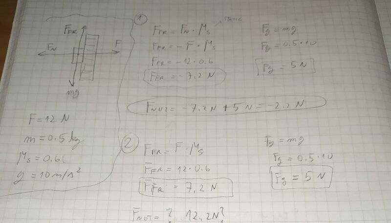

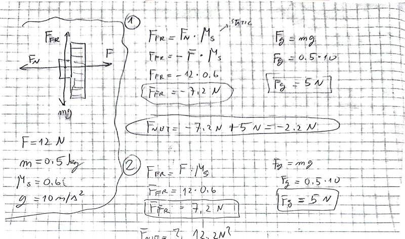

Here is the photo. Problem goes; will the body(0.5 kg) move when pressed with force F=12 N against wall with static coef. of friction = 0.6.
It won't, but that is not what bothers me.
Like I know that for case no.2 I am supposed to subtract, but I wonder why I didn't end up with one force as negative. If we pretend that I don't know that I am supposed to subtract one force from another, how would I end up with -2.2 and not 12.2? Because subtraction is additon of negative number and I don't have any negatives in case no.2.
I know that it's because F and Fn are going in opposite directions and have different signs, but even in most basic problems when calculating Friction force we can use Ffr= Fn×mu or Ffr=mg×mu. And those answers were always the same, or rather I figured that I was subtracting two positives using my knowledge that forces act in opposite direction so it must be subtraction, like, I came to conclusion using intelligence, it didn't conclude itself from math.
So, why is then in textbooks written that Ffr=mg×mu, when in fact is Ffr= Fn × mu.? In magnitude it's the same as Ffr=mg×mu but not in the dirrection.

It is always the normal component of the net force acting on the object.

Noting of course that this is the maximal friction. Friction in a static situation will typically not be equal to normal force x friction coefficient, but rather smaller than that - unless it is really at the limit of slipping.

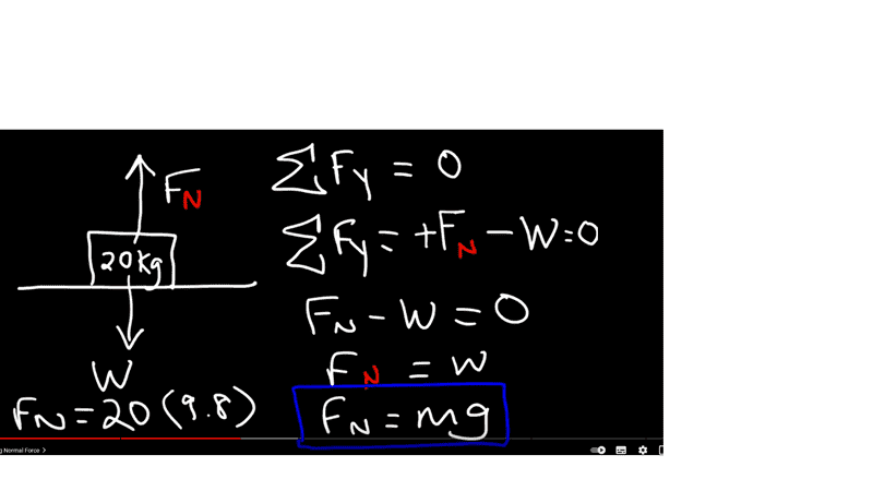

But why do people write Fn=mg, when it's not. It's Fn=-mg
Like this for example.
Why didn't he write Fn=-mg insted of Fn=mg. It's the same in my textbook, and I believe I have seen the same expressions elsewhere.
Like this for example.View attachment 337744
The positive directions of the forces have been specified in the figure. In opposite directions.

Ohh, so if we draw a sketch we can just do the algebra?
The sign of the force component depends on the choice of positive direction. The sign is not relevant for the formula for friction force (static or kinetic) which relates the magnitudes of the two forces (normal and friction).
I should add: It is quite common to introduce force directions in different directions depending on what you would expect to be the force direction. There is of course nothing wrong with doing so as long as you take the correct sign in the equilibrium equation. If your intuition about the direction was wrong, then the force will simply cone out negative, meaning it is in the opposite direction of what you expected.
Of course, there is also nothing wrong with defining all forces with the same positive direction. The sign will then tell you the actual direction.

Thanks, but just to confirm. If we draw a sketch we can just do the algebra like when we are doing normal math equations?
Because it kind of does not make sense that Fn=mg. If he wrote |Fn|=|mg| then okay. But forces are vectors.

But shouldn't we then use absolute values for that? |Fn|=|mg|

As long as you take the appropriate signs into account when writing down the equilibrium equation. In your example, weight is defined in the down direction and the normal force in the up direction. The equilibrium equation in the up direction is therefore Fn - W = 0 (not Fn + W = 0) because weight was defined positive in the opposite direction of the direction you are considering. Therefore Fn = W. Since the weight is mg downwards and weight was specified as positive downwards, Fn = mg. Since Fn was specified upwards, Fn is indeed equal to mg upwards.
