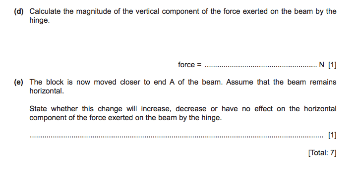

The block is now moved closer to end A of the beam. Assume that the beam remains
horizontal.
State and explain whether this change will increase, decrease or have no effect on the horizontal
component of the force exerted on the beam by the hinge

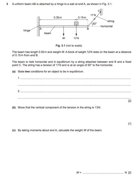

here is the question...

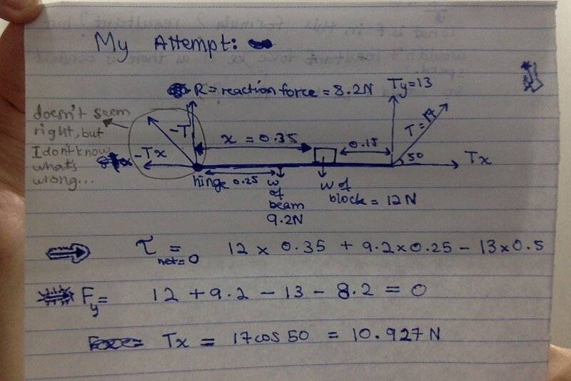

and my question is what would all the forces on the hinge be? and how to calculate them?
and why would the horizontal force at hinge decrease by moving block a closer to end A of beam
So at this late stage I have to discover that ##W## was not given, but calculated ?
You probably answered a with ##\sum \vec F = \vec 0## and ##\sum \vec \tau = \vec 0## ...
And b with ##T\sin\Bigl ({50\over 180}\pi\Bigr ) = 13.023 \approx 13 ## N
In c you calculate 9.25 N from ##\sum \vec \tau = \vec 0##
d uses ##\sum F_y = 0## to get 8.22 N (upward) at the hinge
and e doesn't require you to do any calculating. But ##\sum F_x = 0## tells you the horizontal force the hinge exerts on the beam.
Moving the block does change all three balances and qualitatively you should be able to say that ##T## decreases, and therefore the horizontal force the hinge exerts on the beam decreases as well.

hy = 12 + x
w= 9.2
ty = 17 sin 50 = 13
so x would be 3.8 upwards
so hy = 15.8
and hx 17 cos 50 = 10.9 in opposite direction to tx
but wouldnt the horizontal component remain same always then?

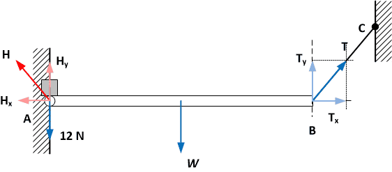

BvU said:
write down the three balances
##\sum \tau = 0 \Rightarrow T_y * 0.5 = W*0.25 ##
##\sum F_x = 0 \Rightarrow T_x + H_x = 0##
##\sum F_y = 0 \Rightarrow T_y + H_y + W + 12 N = 0##

Unknowns are ##H_x, H_y, T_x, T_y## (the first two are pretty obvious, but ##T## also changes ! -- which I wanted you to discover by following the steps I wrote down)

##T_x = T\cos\bigl ( {50\over 180}\pi \bigr )## and ##T_y = T\sin\bigl ( {50\over 180}\pi \bigr )## and
Now we have 5 equations and 5 unknowns

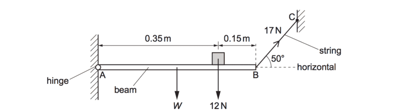

Ok, let's address this question why ##T## is no longer 17 N when the box is somewhere else than at 0.35 m.
In (c) the weight of the beam was established by taking moments about point A :
$$\sum \tau = 0 \ \ \Leftrightarrow \ \ W\times 0.25 + 12\ {\sf N} \ \times {\color{red}{0.35}} - T\sin\Bigl ({50\over 180}\pi\Bigr ) \times 0.5 = 0 $$one equation with one unknown, from which follows ##W = 9.25## N
The position (distance from point A) of the block is prominent in the torque balance.
Now we are a bit further: ##W## is established and does not change when we move the block. The only quantity that can maintain the torque balance is ##T_y## -- and thereby ##T##.
With the block at point A, the torque balance is $$\sum \tau = 0 \ \ \Leftrightarrow \ \ W\times 0.25 + 12\ {\sf N} \ \times 0.35 - T\sin\Bigl ({50\over 180}\pi\Bigr ) \times 0.5 = 0 $$now with W = 9.25 N so that ##T = ...##
Can you fill in the remainder ?

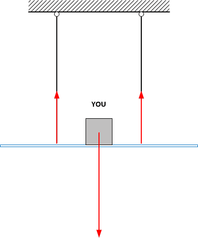

Because the distance from the hinge to the mass changed. Hold a gallon of water at your waist, then raise it laterally. Which position is more difficult to maintain?

erobz said:
Check your own work.
Do they satisfy Newtons Laws?
i tried to, and they sort of did, but i need someone else to confirm...
thank you for giving me the idea to check my own work you know, never thought of that before
