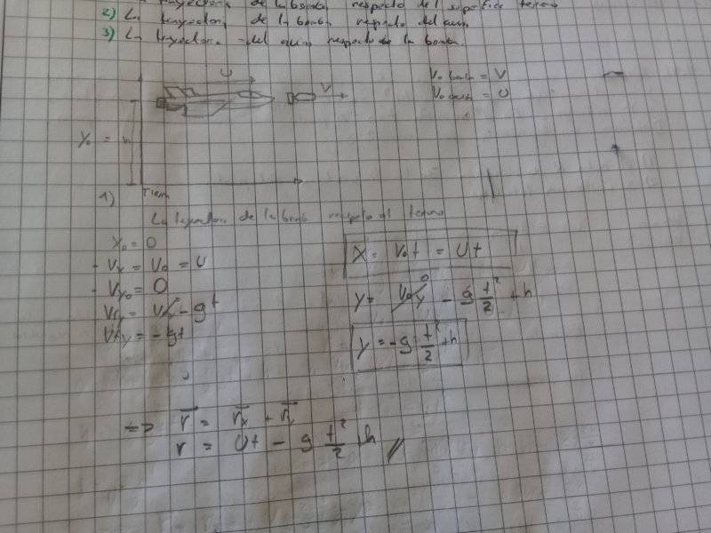

A bomb is launched from the front of a plane horizontally. The inicial velocity of the bomb is ##v##, the inicial velocity of the plane is ##u##. Find:
  1. The trayectory of the bomb with respect to the ground.
  2. The trayectory of the bombb with respect to the plane.
  3. The trayectory of the plane with respect to the bomb.
SUVAT
I tried the first one like is shown in the picture. Is it right? How do I solve the others?
  • Handwritten notes on squared paper deriving the trajectory of a bomb relative to the ground: x = v0t = Ut, y = -g t^2/2 + h, and r = Ut - g t^2/2 + h, with a sketch of a plane releasing a bomb.
Hi,
Nice realistic sketch of the plane :smile:
I miss ##y_0## in your last line ? Where is ##y = 0## ?
re part 2: How about ##\ \vec r_{\rm bomb}- \vec r_{\rm plane} ## ?
BvU said:
Hi,
Thanks. What do you mean by ##y_0##? Isn't it equal to h?. Why ##y=0##?
For the secon one I did ##v_{b/p}=v-u##, you are doing the same but with the positions, right?
SUVAT says ##y(t) = y_0 + v_{0,y} t - {1\over 2} g t^2##. Your picture suggests ##y_0 = h##
Davidllerenav said:
For the second one I did
I don't know what you did, only what you asked

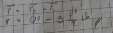

Handwritten equations: r = r_0 + r_1 (vector) and r = v_0 t - g t^2/2 h, with a hand-drawn slash at the end of the second line.
could you read aloud the last line for me :rolleyes: ?
  • Handwritten equations: r = r_0 + r_1 (vector) and r = v_0 t - g t^2/2 h, with a hand-drawn slash at the end of the second line.
Yes, that's why ##y(t)=h-\frac{1}{2}gt^{2}##, since ##v_{0y}=0##
I said that the speed of the bomb with respect to the plane is the speed of the bomb- the speed of the plane.
It means that the position vector is the sum of the position on the x-axis which is ##x(t)=v_0t=ut## and the position on the y-axis which is ##y(t)=h-\frac{1}{2}gt^{2}##. Thus the trayectory would be given by ##\vec r= ut+h-\frac{1}{2}gt^{2}##.
Well well, I had difficulty reading the +h in the last line.
##y(t)=h-\frac{1}{2}gt^{2}## is good. So is ##x(t) = ut##. But I resent $$r = ut +h - g{t^2\over 2}\ .$$You can not add ##ut## and ##h-g{t^2\over 2}## as if they are numbers.
I must add the ##\vec i## and ##\vec j## unit vectors right?
Yes. And then ##\vec r ## is a vector again.
Ok. So the first one is done. Now I just need to do ##\ \vec r_{\rm bomb}- \vec r_{\rm plane}## as you said for the second part right?
I agree. You're doing fine. Bedtime for me :sleep:
