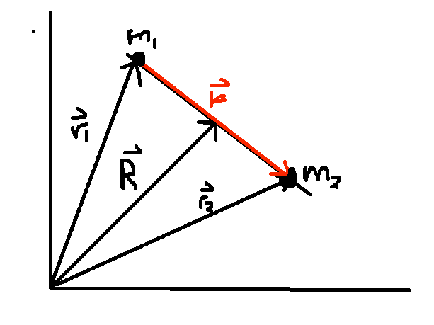

I have attached the image as an attachment
I am reading a classical mechanics textbook and I don't understand how they found that.
r1' = -[itex]\frac{m_{2}}{m_{1}+m_{2}}[/itex]r
and
r2' = [itex]\frac{m_{1}}{m_{1}+m_{2}}[/itex]r
r1' is the vector from the center of mass R to m1 and r2' is the vector from the center of mass R to m2.
Center of mass = [itex]\frac{m_{1}r_{1}+m_{2}r_{2}}{m_{1}+m_{2}}[/itex]

If the origin is at the center of mass (which it is for ##r_1'## and ##r_2'##) then by definition of the center of mass
\sum_i m_i r_i = 0
The distance between masses 1 and 2 being ##r \equiv r_2' - r_1'##, we have
\begin{align}
m_1 r_1' &= -m_2 r_2' \\
m_1 r_1' &= -m_2 (r + r_1') \\
r_1' (m_1 + m_2) &= - m_2 r \\
r_1' &= -\frac{m_2}{m_1 + m_2} r
\end{align}
