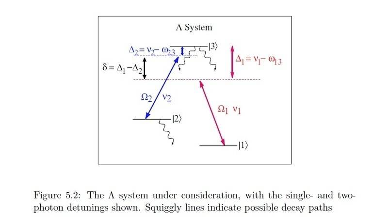

Thank you for answering, I thought dressed states might be a specific term but from your reply, it seems to be more of a general term. I'm reading some unpublished lecture notes on quantum optics and my current issue is in regard to a lambda system (see attachment).
I'm not sure what is ment by a dressed state in regard to this lambda system (or lambda systems in general) and what would the dressed state picture of the lambda system look like?

Of course it has something to do with AC-Stark splitting.
I advice you consider "dressed states" as jargon , denoting nothing more than some quantum system with some quantum states interacting with other quantum systems.
Due to interaction initial quantum system becomes the system with altered quantum states.
Many physicists like to use "quasiparticle" language (they use orthogonal basis of wave functions of some origin, Bloch, Wannier, Legandre,...). They imagine the proceseses as virtual or real exchange of quasiparticles (interaction is wrote down as transfer from one quantum basis state to another basis wavefunction with some amplitude of probability).
This "exchange" they frequently name as "dressing" with quasiparticles. In your case three level system is dressed with laser fields of photons.
