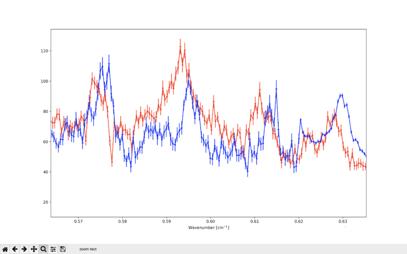

Hello! I am analyzing some data from some rotational transitions between 2 electronic energy levels in a diatomic molecule. I noticed that for different runs that covered the same regions, the peaks we observe are shifted with respect to each other when the power of the laser driving the transition is changed.
I attached 2 such scans below, where the red one has a power of the laser of 2 mW while the blue one has 0.06 mW (they are not normalized for the molecular flux).
Assuming everything else, beside the laser power is the same between the 2 runs (which might not be the case, I need to look more into it, but for now assume it is), what can be the reason for this? I know that bigger power leads to broadening, but not a shift in the central value.
Also the AC Stark shift, as far as I understand, comes when you have a second laser involved i.e. the second laser shifts the transitions that the first laser sees. But I didn't think that the AC Stark shift works with only one laser (is that the case?).
Can someone help me understand what is happening and how can I account for this shift in the analysis? Thank you!

What is the expected precision of the spectrometer?? Was it referenced to a calibrated source? Why is the signal to noise not superior for the more intense laser ?
Surely looks like an artifact.
Did you "close the loop"?:i.e do a third test to duplicate the first?

Thank you for the reply. I have 4 scans, 2 at each power, and the ones at the same power are consistent with each other, but not with the other 2. The linewidth of the laser without power broadening is around 50 MHz and the frequency was calibrated using a Rb transition.
About the SNR, I am not totally sure, but from what I saw in other scans I think the transition is saturated (or close to saturation) so reducing the power might not make the peak smaller.
Are you certain of the direction of the shift (the lineshapes match maybe better if the blue is pushed to the right...this may be silly for other reasons). And of course temperature is always suspect. You might also graph all four sets of data on graph with no interpolation lines but just 4 colors dots. Could show you stuff. I'm just doing a blind analysis here...don't know the system or the physics well enough

I guess my main questions is: can (in general) a change in the laser power produce a shift in the transition frequency between 2 levels? You are absolutely right that there might be other reasons, but I kinda want to get this out of the way, as this is the most obvious change between the 2 scans.
Seems unlikely to me, particularly since you are apparently saturating with lower power and the line shapes seem similar. I am in no way knowledgeable about this system: hopefully somebody actually has specific experience here.

What is the molecule you are studying, and do you know what transition you are driving? What sort of system are you using to produce these molecules (a molecular beam? a vapor cell? something else?). How are you using the Rb reference to calibrate your scans, and what wavelength is your detection laser tuned (close to the Rb transition, or far from it?). The answers to these questions are important to determine whether the frequency shift is due to some mechanical effect (e.g., detecting different velocity classes) or some calibration effect (e.g., laser frequency reference drift).

In theory, you are correct that you shouldn't see an AC Stark shift, assuming that the only thing that changed was the probe light power.
I would agree with above suggestions that you should start by looking for technical issues (laser frequency shifts, referencing problems, etc) before concluding that your molecular line has actually detuned. I would put a little bit of your probe beam onto a wavemeter and see if your frequency is correct. But of course you know your system better than we do.
