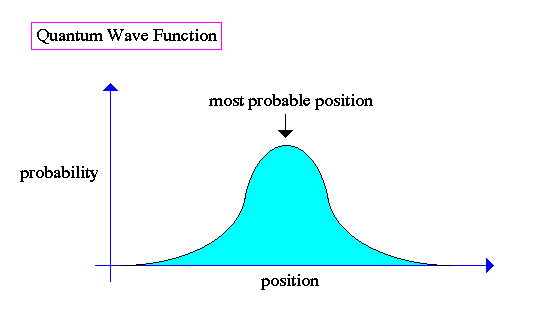

Thanks. Just to check I understand the connection. Let's say you have some simple wavefunction with a range of different possibilities for position like this one:
Let's say you detect the particle somewhere in the middle where it is most likely to be found. The wavefunction has now collapsed as you have identified where the particle is. Therefore you now have a position eigenstate. Are you saying that if you compare the original wavefunction (the graph above) to the function when it has collapsed, the collapsed function will be some multiple of the original wavefunction?

Jimmy, your graph suggests that the particle is not in an eigenstate of position. It only becomes in an eigenstate once it is measured and localised.
Yeh I know - underneath the graph I discussed about measuring it and collapsing the wavefunction into a position eigenstate.
So why are you trying to relate the graph of what was before measurement to what is after? The wavefunctions will not be the same.
Will the collapsed function not have some multiple of the original function as per the first definition in my OP? What does it then mean about being some multiple of the original function? What does it mean by the original function?
Only if your state was an eigenstate before, but then nothing collapsed. A collapse (if you really want to use that concept - it is not necessary) always changes the wave function in weird ways.
Because of the normalisation requirement an eigenstate/function is unchanged by a further measurement of the observable in question.
The eigenvalue (multiple) is the measurement obtained.

Jimmy87 said:
Thanks. Oh I understand now. So if you have a wavefunction like the graph in the other post of mine then you measured and located the particle it would collapse and be in a position eigenstate. This new wavefunction can have various operations done on it. Any operation yielding some multiple of the original collapsed wavefunction eigenstate are also eigenstates? Is that right?
Any operator having position eigenstates as its eigenstates is (equivalent to) the position operator, but you can see what the wave function does if you apply it more than once, sure.
