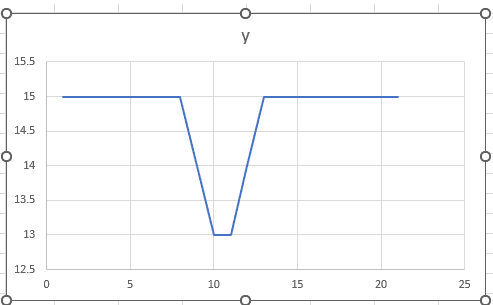

Even the filters before the interferometer are the same issue. One might suppose that stripping out one photon from the uniform coherent wave function might produce a wave function with a hole. Or at least a step function of some kind. That is, you might expect that removing one photon might produce something generically like the following.
And if the wave function after the filters were "bumpy" in this fashion, how could an interference pattern develop? If photons are "digital" then how does the filtering process produce an output that is still both coherent and uniform in amplitude? The same way as previously described. Extracting one photon's worth of energy does not make a hole in the wave function. It decreases the normalization by one. The dip just shown is wrong. The filter removes one quantum of energy and correspondingly one quantum of amplitude from the entire wave function. It is the observation problem again, in still another costume.
Grelbr42 said:
How does a wave function that extends over some macroscopic distance manage to get observed at a specific location?
It isn't a wave function in the sense of the quantum mechanical wave function (which is a complex-valued function in an abstract mathematical space), it is an electromagnetic wave, oscillating electrical and magnetic fields obeying Maxwell's classical equations of electrodynamics. Measuring at a specific location is done by measuring the strength of the fields at that location.
That's not how photons work. Absorbing one photon in a beam of coherent and monochromatic light just leaves you with a (very slightly) less intense beam as tiny part of the energy and momentum of the beam is transferred to the absorber.
