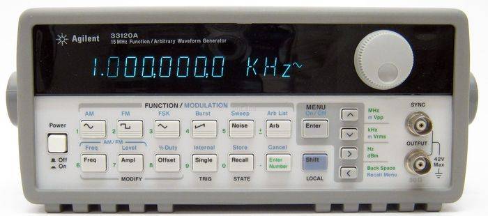

An instrument like the HP 33120 Arbitrary Function Generator is a good tool for this, since you can program many different types of varying waveforms to be output. Then if you need more power, you just use an amplifier in series with the HP 33120 source...
http://www.sglabs.it/public/SgLabs_HP_33120A_1.JPG

Square pulses of around 30-50 ms may work. Previos studies actully used same pulse width and frequency like between 10-20 Hz. So I would first like to try what has been used previsouly.
Thanks for the suggestions HP 33120 but I want to integrate the pulse circuit in my coil assembly.
What do you thin about LM 324 OPAMP?

Another option would be to use your PC's sound card and free software to make a PC-based signal generator. That would give you a lot more flexibility in the waveforms you generate for your experiments. You could make a small power amp for it as well, if it looked like you needed more coil drive power. Just google Free Sound Card Signal Generator Software to see what some of your choices are. :smile:

Rearding the coil parameters, the coils have inductance of (1.5 mH) and current flowing through should be 15 Ampere. Yes now I am thinking on variable AC frequency generator.
Then you will definitely need a power amplifier. If you are doing a grant proposal, include the AFG and a power amp in your equipment list that you need to purchase.
