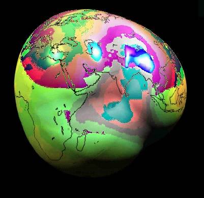

g also varies by a tiny amount depending on local concentrations of mass. The "astronomy picture of the day" for Nov 13, 2001 is a graphical view of variation in g over the Earth.
