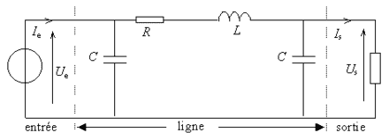

Ok I'm sorry if you didn't understand correctly, I should have been clearer so I'm going to explain again:
The original post has been written by my friend because we thought that the Earth's magnetic field would be problematic for our measurements. Basically we are trying to reproduce an electric line with the PI model( a circuit with a resistor a capacitor and a coil up to 100kOhm, 1microF and 100mH respectively, the maximum we can reach with one component available to us) in order to test methods used by professionals to detect and trace an unknown underground cable.
According to what I've read, DC is useless because it is difficult to measure a static field against the earth’s magnetic field, so we'll need to use AC, but we are afraid that using low values of current (1A max) will make the magnetic field induce undetectable due to the Earth's one, especially because we want to experiment how the value of the current affects the distance a signal induced by it can affect the distance the given signal can be traced, so we'll probably need to start with a value lower than 1A.
You asked for the scale of the experiment, we'll use what you find in a school for experiment, the component will not be extravagant, we just need to determine the length of the circuit to detect an effective signal reduction, but I assume adding some meters to the circuit won't be a problem
Will you directly excite the PI with a low frequency signal, then use a portable receiver to locate the signal from the cable?
If the PI is a model of the underground conductor, with the inductor antenna being an point source signal, then it will not be a line source like an underground conductor.
A professional detector will accurately find the centre and alignment of a buried conductor.
That cannot be done with a point source.
This is a PI representation. The resistor reproduces the losses by Joule effect, the coilrepresents energy storage in the form of a magnetic field around and in the line (self-induction) and the capacitor the capacitive coupling between the line and the ground. If I understood correctly, you're asking if the coil is use to induce current inside the line, the answer is no, it is part of the model.

yes that's the idea(on the schema, entrée means entrance, ligne = line and sortie = exit)

Yes the goal isn't to have the most accurate values , but to experiment various parameters that can influate the propagation of the signal (like frequency or intensity) that will follow the line, allowing us to trace it by detecting the magnetic field induced.

You need to acknowledge that whatever you are tracking underground is just one conductive pipe, or a bundle of wires, probably inside a metallic shield.
Your low frequency model of a transmission line is then that pipe or bundle, seen against the ground it is buried in. The top wire in the model is the pipe or line, the lower wire in the model is the Earth itself.
At the near end of the line, a current signal is applied to the pipe or conductor bundle, referenced to a ground stake. At the far end of the line, the pipe or line bundle is grounded to an Earth stake.
Alternately, the signal can be inductively coupled into a long line with a split-core current-transformer.
Your detector or receiver is then free to roam, in search of the AC magnetic field radiated by the conductive underground line.
