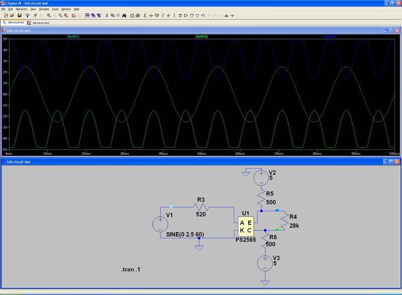

Hi, I am trying to design a circuit to keep my microcontroller safe from any sudden voltage spikes. Here is a picture of my circuit. The ac source on the left represents the Ac main voltage from the house @ 120V 60Hz stepped down to 2.5v 60Hz. The 28k resistor on the right represents the internal resistance of the microcontroller.The maximum voltage into the adc would be 10V in the μA current range.
The purpose of this circuit is to have the microcontroller read in the voltages with its onboard adc.
Right now, i am not exactly sure what the "correct" output waveform from the opto would be. I was expecting a sine wave at both the emitter and collector. The Blue waveform is Voltage taken at the emitter, green at the collector, and the sine wave is taken at the source.
Can someone please comment on my circuit design/outputs and suggest ways to make this a viable solution? Any suggestions are welcome! I am an undergrad with much still to learn! Thank You.
The bias conditions seem to be wrong for these components.
If you go to the "edit simulation cmd" section and choose "DC sweep", you can sweep V1 and determine the correct DC offset for it by looking for the linear area in the graph. Sweep from -20 V to +20 V in 0.1 V steps.
The DC offset is set in the properties of V1 which you get to by right clicking on the component (as you did to set up the sinewave).

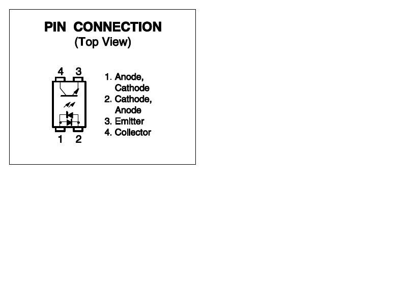

I notice that your opamp seems to have a protective diode in it across the LED, and this may explain the half wave rectifying effect.
Your micro would probably need 0 to 5 volts as its input, so that negative supply might produce negative output unless you set up the bias correctly.
Note output frequency is double input frequency, as if signal were full wave rectified.
Note collector and emitter are both at supply rails in vicinity of input zero crossing.
Circuit is doing just what it should - transferring current from whichever of its input LED's is forward biased to output phototransistor. When input is too near zero to make either LED conduct no transfer occurs, of course.
Are you trying to use the optoisolator as a linear device that reproduces your input signal? You might get away with it by reducing input drive and adding some DC bias so you're only using one of the input LED's .
However, what you have looks to be reproducing the peaks better than i would have imagined it could. Just it inverts half of them.
I learned something here - thanks !
Thanks Vk6 and Jim for the responses. We were able to come up with a solution through adjusting the DC offset and bias, thanks to your suggestions.
