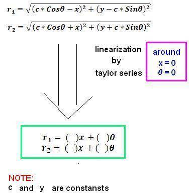

Welcome to PF!
Hi e135193! Welcome to PF!
hmm … (c cosθ, c sinθ) is the point at angle θ on the circle of radius c round the origin.
r1 is the distance from that point, and r2 is the distance from the opposite point, (-c cosθ, -c sinθ).
but I don't understand what you mean by "linearization of the equations around x = θ = 0"

e135193 said:As you see equations are non-linear. I need equations like in the picture below. I heard that it can be made by using taylor series.
Hi e135193!
(btw, anyone who contributes to a thread gets an email whenever someone else replies, so there's no need to use PMs.
This may help: √(1 + x) = (1 + x/2 + …); sinx = x + … ; cosx = 1 - x²/2 + …
But what I don't understand is that you have three variables, x y and θ, for a 2-dimensional situation.

Thanks for your interest to help me.
I'm sorry about the insufficient information. The "y" and "c" terms are constants.
Then, there are only 2 variables, x and θ.
Can you help me further from that because I am not good at mathematics.

I once walked into a test on differential equations that asked for the "linearization" of a non-linear de and I had no idea what "linearization" meant! Turns out it's easy.
You have
r_1= \sqrt{(c cos(\theta)- x)^2+ (y- c sin(\theta)^2}
r_2= \sqrt{(c cos(\theta)+ x)^2+ (y+ c sin(\theta)^2}
and you say that c and y are constant. So you want linear functions for r1 and r2 in terms of x and \theta. You don't really need the full "Taylor's series", you just need the tangent line equations (which are the order one Taylor's Polynomials).
In general, if r= f(x, \theta), then the "tangent plane" approximation, about x= 0, \theta= 0, is given by
r= f(0,0)+ \frac{\partial f}{\partial x}(0,0) x+ \frac{\partial f}{\partial \theta}(0,0)\theta
Find the partial derivatives of your functions and plug into that.

Hi e135193!
ok, y and c are constants.
So r is a function of x and θ.
What is the derivative ∂r/∂x? It's the rate at which r increases if you increase x (but leave θ fixed).
So if you only go a very small distance (in x), then r depends linearly on x, and the factor is ∂r/∂x. Similarly for ∂r/∂θ.
Work out ∂r/∂x and ∂r/∂θ, and then find their values at (x=0,θ=0).

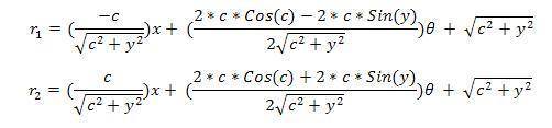

Hi e135193!
I'm sorry, but i have no idea how you got that …
are they supposed to be ∂r1/∂x and ∂r2/∂x, or what?
and where did those √(c² + y²) some from?
We'd better start with:
what is d/dx of √(x² + px + q)?

e135193 said:The equation I found is that the linearized one of the non-linear equations.
oh … now I understand.
Your -cx/√(c² + y²) and your + √(c² + y²) are correct,
but I've no idea how you got the cos(c) and the sin(y) in the middle (presumably from your ∂/∂θ).
Do the ∂/∂θ again, and this time show your working, so we can see where you're going wrong.

I used Mathematica for that partial derivative.
you say it is wrong. Then show the corrcet solution.
please I have to do this otherwise I will fail and I lose my scholarship.

Hi e135193!
Words almost fail me!
You clearly have no idea how to do elementary calculus.
No-one on this forum will do your work for you.
I've tried to talk you through this problem, but you haven't cooperated, and it turns out you can't even use Mathematica properly, or even recognise when it churns out nonsense.
If you can't do elementary calculus in your head, are you even doing the right course for you?
e135193 , I think you'd better come clean and start a new thread in the Academic & Career Guidance sub-forum, and explain your present academic situation and ask for advice.
There are plenty of people on this forum who have experience of your situation, and who can advise you, if you ask.
