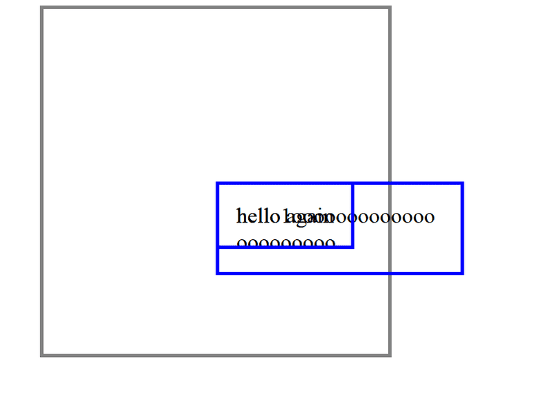

It's still not working.
HTML:
.container {
  position: relative;
width: 500px;
  margin: 20px auto;
  padding: 500px;
  border: solid grey 10px;
  -webkit-box-sizing: border-box;
     -moz-box-sizing: border-box;
#content {
position: absolute;
display: block;
margin: 0 auto;
  padding: 50px;
  border: solid blue 10px;
}<div class="container">
    <p id="content" style="font-size: 48pt; display:block; width:600px; word-wrap: break-word;">hellooooooooooooooooooooooo</p>
    <p id="content" style="font-size: 48pt; display:block;" >hello again</p>
</div>
  • Rendered web page: a grey bordered box containing two overlapping blue bordered boxes with text; the first reads 'hello again' and a long line of repeated o's wraps onto a second line, with the boxes overlapping each other.
Sure no problem, thanks for your help either way!
