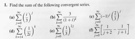

Please refer to the attached image.
How do I do these questions, In particular
1a, 1c and 1f.
Could anyone give me a hint to get me started with either of these?
Thanks.

Don't let the $i$'s get to you! For instance, in 1(a), $\displaystyle\sum_{j=0}^{\infty} \left(\frac{i}{3}\right)^j$ is geometric since $\left|\dfrac{i}{3}\right| = \dfrac{|i|}{3} = \dfrac{1}{3} < 1$.
Note that you can rewrite 1(c) as $\displaystyle\sum_{j=0}^{\infty}\left(-\frac{2}{3}\right)^j$.
Note that 1(f) is a telescoping sum; with that said, we see that
\[\sum_{j=0}^{\infty} \left[\frac{1}{j+2} - \frac{1}{j+1}\right] = \lim_{n\to\infty} \sum_{j=0}^n \left[\frac{1}{j+2} - \frac{1}{j+1}\right] = \ldots\]

Although, for
1a) it says that the sum of the series is
$\frac{1}{1-\frac{i}{3}}$ $ = $ $\frac{9+3i}{10}$
Why is this? I am unsure how they get to the first term of $\frac{1}{1-\frac{i}{3}}$

Note that
\[\frac{1}{1-\dfrac{i}{3}} = \frac{3}{3\left(1-\dfrac{i}{3}\right)} = \frac{3}{3-i}\]
Now conjugate and you'll get the desired result.

this i understood,
what i did not know was how they arrived at the sum being equal to
$\frac{1}{1-\dfrac{i}{3}}$
Use that power series
$$\frac{1}{1-z} = \sum_{k=0}^{\infty}z^k \,\,\,\,\,\,\, |z|<1$$
