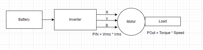

Understand the logic of output power of motor using inverter
I am trying to decode and understand the output of the inverter
I have doubt on the PIN, suppose the load is increasing on the motor then it can be done in two ways, suppose the initial Pout requirement is 1KW, it can be done either by controlling the voltage or current. Now how do I control the voltage separately and current separately? I mean i want to put the constant voltage and increase current or keep current constant and increase voltage, Is it possible?
The output of the inverter will generally be a constant AC voltage, to the extent that the inverter's output impedance is low compared to the load that it is connected to. The current varies in the load according to the impedance that the load presents to that constant inverter output AC voltage.

You cannot choose a voltage, apply it to a load and then change the current without changing the voltage or the characteristics of the load. They are interdependent.

Do you remember the old favourite I = V/R ?
Your motor is basically a Resistor (ignore the reactances for simplicity) Unless you can somehow change the Resistance of the motor then V and I are tied together. What are you trying to achieve here? Give a reference to your plan.

Brushless motors are basically multiphase AC motors and the supply is produced as with a (basically) normal inverter. Speed is controlled by using a variable frequency. As the load increases. the inverter circuit provides more current to keep the supply volts the same - a mechanical overload and the supply will run out of current and the motor can stall.
