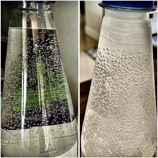

I performed a simple test:
First, I briefly opened and closed a plastic mineral water bottle to allow air exchange.
Then I left it untouched at room temperature for about half an hour, until multiple gas bubbles formed inside.
After that, I placed the bottle in the freezer.
What caught my attention was that the air/gas bubbles trapped inside did not collapse, deform, or rupture — even after full ice solidification.
• The plastic bottle remained intact (no signs of deformation or pressure stress).
• The gas bubbles retained their spherical shape.
• There was no visible shift, compression, or expansion rupture.
• I observed the bubbles under a microscope before and after freezing. No collapse.

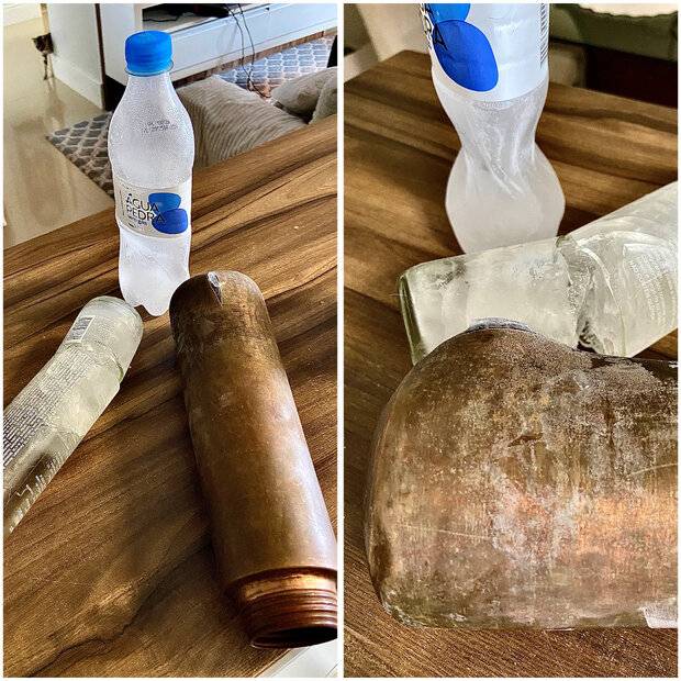

I had previously lost a 100% copper bottle to ice pressure. So the fact that not only the plastic bottle showed no deformation — but even the gas bubbles inside remained untouched — left me genuinely perplexed.

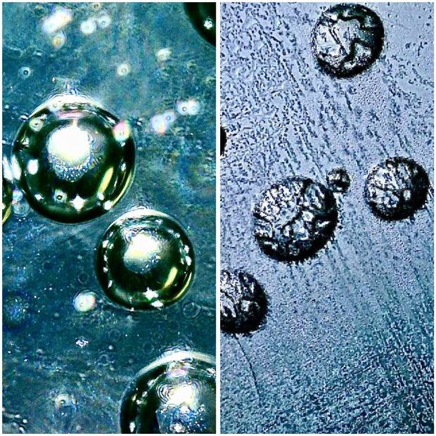

Thank you again for the reference and engagement.
As promised, I’m following up with the visual evidence that led me to raise this question in the first place.
The experiment, as described, is simple. But the results are difficult to reconcile with classical thermodynamics.

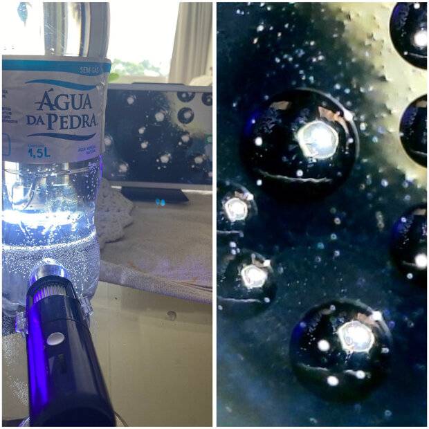

Attached are three image sets:
1. Direct visual setup:
A sealed 1.5L plastic water bottle, with bubbles clearly visible — and a microscope live-feeding the exact same bubbles onto a tablet.
This is not speculative. This is direct.

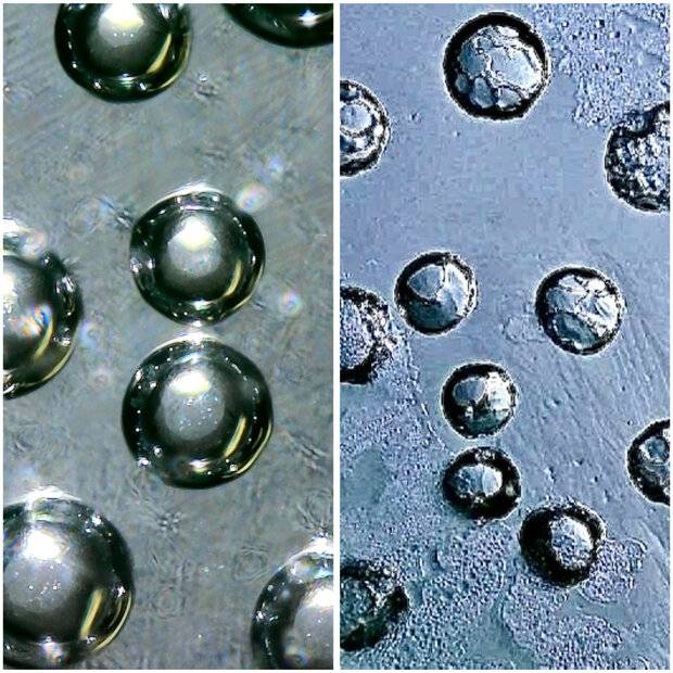

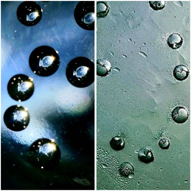

2. Before vs. After #1:
In the liquid state, the “gas” bubbles are spherical, smooth, structured.
After freezing, they collapse — but not uniformly. They break apart, showing internal fragmentations.
3. Before vs. After #2:
Once again, the “gas” bubbles appear hollow and coherent before.
After freezing, internal structures rupture — not what we would expect from inert trapped gas.
These were all viewed using only refracted light.
No dyes. No additives. No speculation.
And now, my question stands louder:
  • If these are just gas bubbles, why do they appear structured under refracted light?
  • Why do they fracture like biological cells, not compress like gas voids?
  • Why does freezing not deform the bottle — but breaks what’s inside the bubbles?
The paper you referenced explains formation of new bubbles during freezing.
But it says nothing about pre-existing large gas structures showing post-freezing fragmentation.
I’m not here to speculate. I’m here to ask:
How does classical physics explain this?
Why do you think that? The paper I cited used classical thermodynamics.
I had thought this thread would be better than the previous one. But let’s be very clear for both this question and future questions:
Just because you don’t know how some observation is explained using standard theories doesn’t in any way imply that the observation is incompatible with said theories. Until you have studied a topic at the graduate level you simply are not qualified to make such an assessment. Asking questions to learn something is good, but assuming that you know there is no answer is premature.
By the way, I have not studied thermodynamics at the graduate level. So even if someone like me doesn’t know the standard thermodynamics answer, it is still premature to claim that there isn’t one.
It does deform the bottle too. But what you are seeing in the bubbles is deformation and stress of the ice itself. The gas just compresses; it doesn’t break.
Ice forms many different crystalline structures. See here: https://en.m.wikipedia.org/wiki/Phases_of_ice with Ih II and III all being in typical ranges for sealed vessels in ordinary freezers.
And even without forming different crystalline structures, the same crystalline structure can be oriented differently with optically visible fissures between crystals. This is probably primarily what you are seeing.

If the internal pressure is sufficient to rupture copper in certain setups, how do we explain the fact that in a glass bottle, these same “gas” bubbles vanish completely before the bottle itself breaks — while in plastic bottles, the bubbles remain intact, despite minimal or imperceptible deformation of the plastic? We’re preparing to record and share this comparative experiment, as we believe it may shed further light on the issue.
