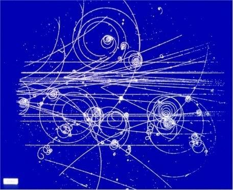

Bubble and cloud chambers and more advanced versions. Cloud chamber is pretty easy to do yourself if you havy any uranium (United Nuclear sells small quantities) and some dry ice + alcohol.
http://en.wikipedia.org/wiki/Cloud_chamber
http://en.wikipedia.org/wiki/Bubble_chamber
