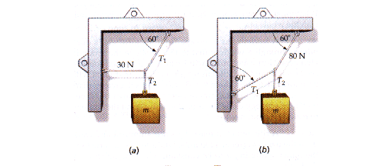

For the systems in equilibrium in the figure below, find the unknown tensions and masses
ΣF = ma = 0
Here are two questions for my online homework. In part (a) we have to find T₁, T₂, and m.
For part a, I drew a free body diagram and used that ΣFₓ = -30N +T₁cos(60) = 0 To find T₁ = 60N. The software accepted my answer. Now we have to find T₂ and m. We have ΣFᵧ = T₂ + T₁sin(60) + mg = 0. We do not know T₂ and we do not know m. So how can we solve for both?
You need to be clear about what your force balance equation represents. ΣFy on what, exactly? Since you have the three tensions in there, it must be the force balance on the knot. The knot doesn't "know" anything about m - that's somewhere else.
To get mg into it you need to consider the force balance on the vertical string.
rtareen said:
Homework Statement:: For the systems in equilibrium in the figure below, find the unknown tensions and masses
Relevant Equations:: ΣF = ma = 0
For part a, I drew a free body diagram and used that ΣFₓ = -30N +T₁cos(60) = 0 To find T₁ = 60N. The software accepted my answer. Now we have to find T₂ and m. We have ΣFᵧ = T₂ + T₁sin(60) + mg = 0. We do not know T₂ and we do not know m. So how can we solve for both?View attachment 257619
mg should not be in the vertical force balance on the junction.
I didnt know we had to consider the junction separately from the mass. Now I can probably do it myself. Thank you
Thank you. I now know to consider the knot separately from the hanging mass.
The question is, do you know why?
I think I do. It is because all of the tensions are actually acting on the junction, not the mass itselfwhile only one of those tensions are acting on the mass. Am I right?
Yes.
