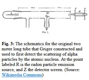

Dear sir, I am a high school student, so this is for schoolwork.
While learning about Rutherford's gold leaf test in the study of atomic structure, I was taught that it was done by shining a beam of accelerated alpha rays on a gold leaf. Alpha rays can be blocked by air or by paper. So how did he make the thickness of the gold so small?(thikness of gold foil- 0.6 μm)
Yes, so they used an evacuated tube for the experiments, it appears:

The original Geiger article can actually be found:
https://royalsocietypublishing.org/doi/pdf/10.1098/rspa.1910.0038
Geiger comments on metals being "available" in different thicknesses, except tin, which was "available" in only one thickness. Suggesting that Geiger used foils prepared by others for other purposes, and was restricted to thicknesses others had chosen.
