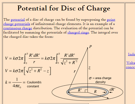

I have a question on finding potential for a disc of charge when it comes to the simple integration
how does the integral of R'dR'/etc have the R'dR' just disappear? i thought it would then be R^2/2
I am obviously missing something here

The integral in question is not simply of R'dR'. Note that the denominator contains ##\sqrt{z^2 + R'^2}##.

u-substitution ##u = z^2+R'^2## is applied.

Assuming you have looked up this integral in tables of same, I think what you're missing is the assumptions about the variables and z that would make the problem trivial if only you knew what they are. Even if you have success using the methods others have suggested earlier, looking for assumptions is a useful exercise that can pay off later on...
As an aside, it took me a while to get Mathematica to solve your integral. The evaluation hung up until I specified the assumptions required to give an unambiguous answer (The same one, even!). MMA's both interesting and frustrating that way. In order to be as general as possible, it makes few assumptions but provides the user with methods to specify them.
