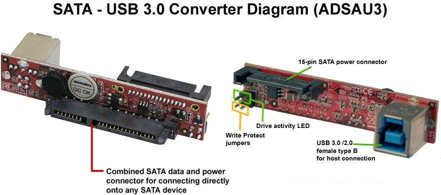

in latter example does it use embeded software or only does this with special circuits?
I assume you're referring to the SATA ##\leftrightarrow## USB 3.0 interface. Typically, none of that would be done at the software level, but some of it might be done as one-time ROM firmware. I don't know the specifics of any particular such device, but you can see from the following image that it does power handling and 'mapping' one set of pins to another, with some small IC chips to manage the bidirectional data flow with conversion, synchronization, and throughput assurance.
Diagram titled SATA - USB 3.0 Converter Diagram (ADSAU3) showing a red circuit board with a combined SATA data and power connector, a 15-pin SATA power connector, drive activity LED, write protect jumpers, and a USB 3.0/2.0 female type B host connection.
