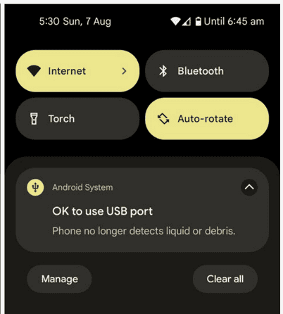

I had a shift outdoors yesterday where it was raining off and on. I was mostly under EZ-Up tents, but was out in the rain a little and there was plenty of moisture blowing in the air from the foggy conditions.
Part-way through the day, after the rain had let up for a few minutes, I happened to see a notice on my Google Pixel 6 cellphone similar to this one:
Android phone quick settings screenshot showing a notification from Android System reading OK to use USB port, Phone no longer detects liquid or debris, with Manage and Clear all buttons.
https://candid.technology/liquid-or-debris-in-usb-port-pixel/

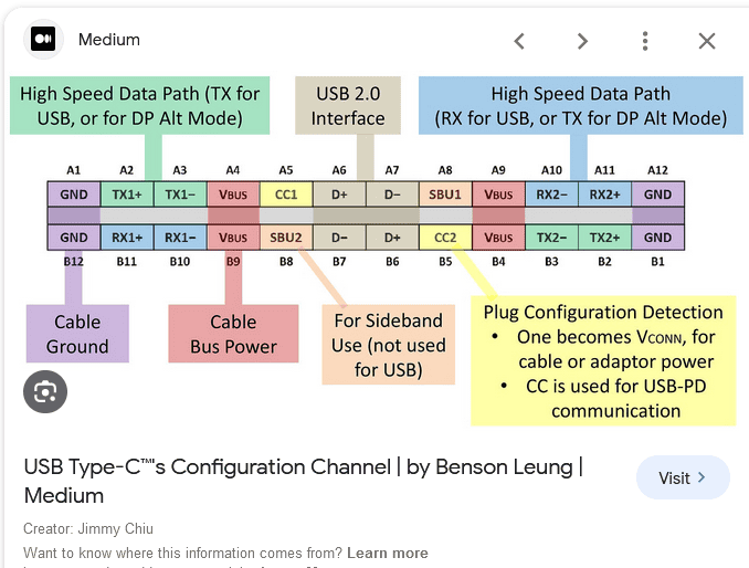

I'd never seen something like that before (and was happy that it was reporting that all was okay), but it got me wondering how the phone can detect when some moisture gets into the type-C USB port. Does it look at leakage current between the 5V and Ground pins, or some other characteristic between the other lines in the type-C connector? I've worked mostly with circuitry for type-A and micro-USB connectors, and not so much with type-C, so maybe this is a feature of type-C only?
Diagram of the 24-pin USB Type-C connector pinout, labeling pins A1 to A12 and B1 to B12, with callouts for VBUS, CC1 and CC2 plug configuration detection, SBU sideband use, and high-speed data paths.
https://medium.com/@leung.benson/usb-type-c-s-configuration-channel-31e08047677d
Thanks for any insights. :smile:
I think there's a moisture sensor in the port. Per Samsung:
Devices with a waterproof rating of IP68 and above (most of the Galaxy series) are equipped with a moisture detection sensor to prevent water damage to the device.
I assume the same is true for other brands.

Fantastic! Thanks Drak. So it's not a feature that is built-in with generic USB-C ports, but an additional detection device in the USB-C port of these devices. Cool stuff. :smile:
It must be an impedance measurement between the pins, since it recovers quickly. Other sensors (magnetoresistive, etc.) take longer to recover. They are also an extra part to add into a tight space. An integrated microcontroller could do the impedance measurement.
