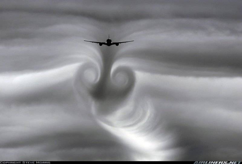

Since the air can't continue to flow downwards aft of the trailing edge of a wing it ends up flowing forwards and backwards (and outwards at the wing tips). The forward flow that starts under the trailing edge and continues forward under the wing reduces drag, which is partly why ground effect flight takes less power. As mentioned, there's also a pressure increase below the wing, due to the impact of the downwash with the tarmac, which reduces the angle of attack required to keep the aircraft in ground effect, further reducing drag and the power required to maintain ground effect flight.sophiecentaur said:On the runway, the plane needs no energy to maintain its lift because the tarmac goes nowhere.
In order to produce lift, a wing has to have an angle of attack with respect to the direction of travel of the air craft. Most of this could be due to the cambered upper surface of a wing. The point here is that there is a vertical component of distance along the lift producing surfaces of a wing. For all normal wings, the direction of the "exit velocity" is mostly downwards (downwash related to lift) and somewhat forwards (forwards wash related to drag).boneh3ad said:Lift is orthogonal to the direction of motion, so there is no work being done by the lift.
The situation is somewhat like a propeller, except that a propeller operates within it's on induced intake wash, and the amount of energy added to the air is much greater. From this Nasa article:
We can apply Bernoulli's equation to the air in front of the propeller and to the air behind the propeller. But we cannot apply Bernoulli's equation across the propeller disk because the work performed by the engine (propeller) violates an assumption used to derive the equation.
http://www.grc.nasa.gov/WWW/K-12/airplane/propanl.html
Since a wing does not operate in it's on induced intake wash (like a helicopter in forward flight as opposed to hovering), there's some increase in downwash in addition to the pressure jump that occurs with a propeller.
