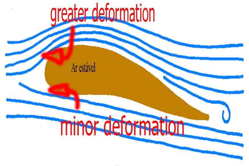

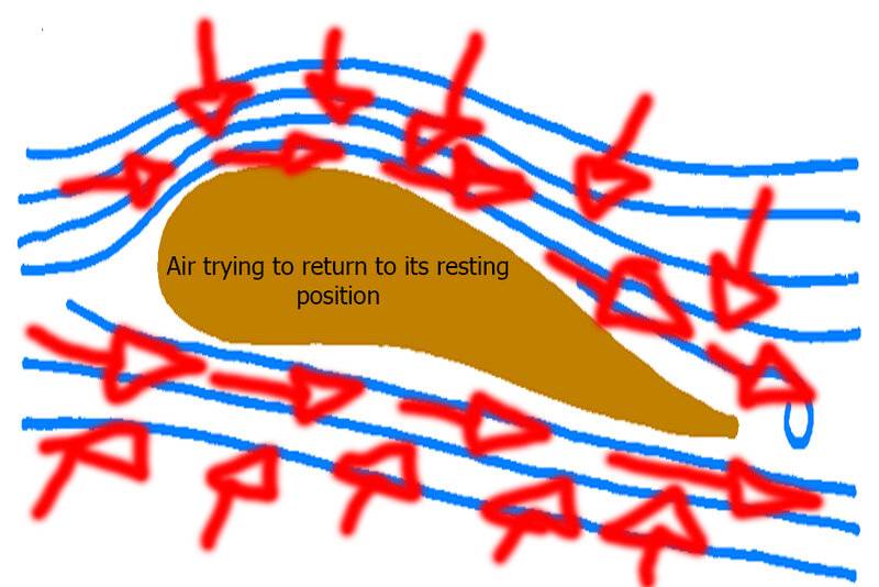

Today during my class I had this idea and I would like to know your opinion.
Basically the air works like a spring, it always tries to get back to its resting state. And it's like Hooke's law, the more it deforms the more elastic potential energy it has. That's why the faster you are, the air resistance is greater. Thinking in this way, I imagine that in fluid mechanics the particles on the top of an airplane wing will travel faster than those on the bottom because they have suffered a greater deformation. I asked some people and no one could explain it to me, so I would like to know your opinion. And I'm Brazilian, so forgive me for my English, and I'm here to try to explain if anything sounded weird.

Probably not a useful analogy. Your statement is too general to be useful. Keep the concepts separate.
Potential energy is stored when compressing a gas or a spring, but;
When you compress a spring, the force is linear with length, Hook's Law.
When you compress air with a piston in a cylinder, the pressure rises slowly at first, then approaches infinity as the volume approaches zero and the air gets hot.
Many low-speed fluid dynamics problems can assume that air is an incompressible fluid, like a liquid. Air resistance is the force needed to move a mass of air, out of the way of a moving object, no compression need be considered.

And that´s the key evidence. Air in a confined airbag indeed behaves like a spring, but when air is free to flow out and around, its compressibility is a minor contributor to resistance and lift. That will change when you approach speed of sound.
No, that's not correct. Let's replace 'deformation' with 'compression' since deformation applies more to rigid bodies and not fluids. The air on the underside of the wing is actually more compressed than the top since it is slamming into the wing's lower surface, while the air going over the top is less compressed, flows at a faster rate, and generates a pocket of low pressure that helps generate lift when combined with the high pressure underside.
The underlying reason why the topside air flows faster is a bit beyond my understanding. My best guess is that it's because the topside air is moving from an area of higher pressure in front of the wing (where it may have been compressed) into a region of lower pressure above and behind the wing's upper surface, where the airfoil is leaving behind a slight 'void' by moving the air out of the way as it passes. Then throw in some other things like the difference in velocity between the streamline next to the skin of the topside airfoil and the streamlines just above that one...Bernoulli's principle or something... and in the end you wind up with a low pressure pocket above the wing. I think. That's mostly me piecing different things together from various things I've read.

I would say that it is the inertia of the molecules of air what offers resistance to any perturbation, rather than the capability of a group of molecules to be compressed or expanded.

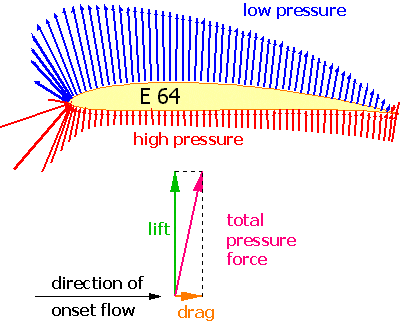

Regarding a wing, according to your reasoning, the top airstream should be resisting and pushing down the wing harder than the less deformed bottom airstream pushes it up.
Actually, the top airstream is sucking the wing up, as any pressure distribution diagram shows.
The shape of the leading edge of the wing is very important to achieve that, reason for which lift enhancers (slots, turbuletors, etc.) and de-icing devices are mainly located there.
