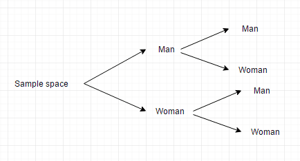

while in the married man/woman problem, i was treating with the experiment like this:
Tree diagram with Sample space branching to Man and Woman, and each of those branching again to Man and Woman, giving four leaf outcomes: Man, Woman, Man, Woman.
and this is wrong because man and woman are not all possible outcomes of this experiment, i mean it is not like a coin which will give you a tail or head, so P(M)P(W|M)+P(W)P(M|W) is wrong because it is based on a wrong tree, while this:

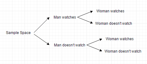

Tree diagram from Sample Space branching to Man watches and Man doesn't watch, each then splitting into Woman watches and Woman doesn't watch.
is a right tree and can be used to get the correct values
