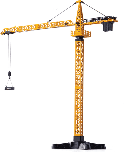

You have a design problem statement, which gives you numerical specifications for performance, spatial constraints etc, and you have finally come up with some mechanism ideas you synthesised into a machine concept.
You’ve sketched your design’s parts and the final assembly.
So: How do you now go about calculating the dimensions of your undimensioned design?
It may be easier to consider a specific case. Take a crane for example. How would you go about setting the dimensions? What would the requirements say about dimensions?
Those numerical specifications must translate into dimensions somehow.
To give you a hint about the problem proposed by @anorlunda , everything is centered on the weight hanging at the end of the rope. What are the numerical specifications for what you hope to achieve with this weight?
