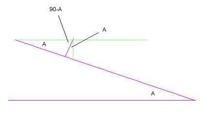

Here's a diagram if it's viewable... a bit small, but I had to scale it...:biggrin:
It's strange, but I have a real problem discerning X and Y components. I know I need to skew the X and Y axis but then I have a hard time with the free body setup with regard to SIN, COS etc... I know it's really simple...
thanks again
Here it is. As you can see, the angle between the normal and the vertical is 30.
Thanks for your reply. I'm with you. So, what's the easiest way to draw the free body accurately each and every time if I'm not given those angles (N and mg) and there's a box sitting on an inclined plane or an object on a hill that forms an angle, theta, with the ground or horizontal? I've got it in a book here but it doesn't seem very intuitive -unless I'm making something very simple more difficult. What approach do you take?
You should be able to see from the diagram that the angle between the vertical and the normal to the plane is always the same as the plane angle with the horizontal.
There's not actually an approach, it's simple geometry. Your diagram was no good because you hadn't drawn the angles. Bone up on elementary geometry.
