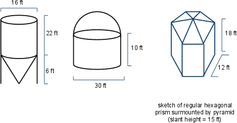

http://puu.sh/d5FpW.png
∫∫(∇XF)⋅dS = ∫F(r(t))⋅r'(t)dt
So I figured I'd have two line integrals (using Stokes's theorem.
Paramatizing S1:
I can think of the cylinder as the closed curve circle x²+y² = 9 on the x-y plane right?
x = 3cost, y = 3sint, z = 0; 0 ≤ t ≤ 2pi
or r(t) = (3cost)i + (3sint)j
Then F = (27(cost)^3)i +(2187(sint)^7)j
The dot product of F and r'(t) gives me
-81sint(cost)3 + 6561(sint)^7cost
Then I integrate this from t = 0 to t = 2pi and get 0.
For S2:
Similar to S1, I can think of this hemisphere as the circle
x²+y² = 9 on the x-y plane with z = 8 right?
Then paramatizing:
r(t) = (3cost)i + (3sint)j + 8k ; 0≤t≤2pi
I go through the same process as S1, but I don't get 0 I get -576 pi, which is obviously wrong.
Would someone mind walking me through how to do this problem correctly?Am I applying Stokes's theorem incorrectly.
The only boundary of the silo/hemisphere is the circle in the xy plane, and you got zero for that.
Hi LCKurtz, thanks for your reply.
I was thinking I may only need to do the integral for S1 since, as you said, both surfaces share a circle in the xy plane as the boundary, but thought that made the problem too trivial.
So instead of splitting the surface into two parts S1 and S2, I can think of it as one surface like the middle image in this picture:
Three side-view diagrams: a cylinder of width 16 ft with a 22 ft top section and a 6 ft cone base; a cylinder of width 30 ft with a hemispherical dome and a 10 ft height; a regular hexagonal prism with a pyramid on top, 18 ft tall pyramid, 12 ft prism height, slant height 15 ft.
so what I calculated for S1 is for the entire surface as well?
Yes. One way to think of it is if that surface was flexible rubber or a soap bubble, it could contract down to just the disk inside that circle. Any way you deform the surface still has that boundary.
