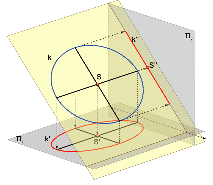

Thank you. Here's my solution which was confirmed to be right.
Since I got that the integral evaluated to -8 times the area of the ellipse, I wrote the answer as ##-8\pi ab## where ##a## and ##b## represent the major and semi-major axes. I used the attached diagram to evaluate the axis lengths. The major axis has a length of that of the radius of the circle.
To find the semi-major axis, I drew right triangle with the hypotenuse being the radius of the circle and one of the sides being a horizontal line (on the diagram, the line would be horizontal on the ##\Pi_2## plane passing through ##S"##). The side length is the semi-major axis length and is the hypotenuse times the cosine of the angle ##r\cos(\theta)##.
The angle formed is the angle between the ##xy## plane and the plane with the circle is the angle between the normal vectors of the planes. The ##xy## plane has an equation ##z=0## so the normal vector is ##\langle0,0,1\rangle##. The normal vector of the plane with the circle is ##\langle1,1,1\rangle##. Here: $$\textbf{a}\cdot\textbf{b}=\vert{\textbf{a}}\vert\vert{\textbf{b}}\vert\cos(\theta)$$ $$1=\sqrt{3}\cos(\theta)\rightarrow\cos(\theta)=\frac{1}{\sqrt{3}}$$
Hence the semi-major axis length is ##\frac{1}{\sqrt{3}}## since the radius is one. Then the integral evaluates to $$-8\pi ab=\frac{-8\pi}{\sqrt{3}}$$

Ok, good. Now, the easy way is to simply use that the area element is the unit surface normal multiplied by the infinitesimal area. Normalizing the vector ##\langle 1,1,1\rangle## gives a factor ##1/\sqrt 3## and the area of the circle of radius 1 is ##\pi##. Hence ##-8\pi/\sqrt 3##.
