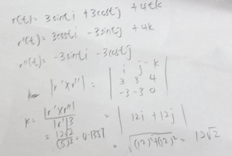

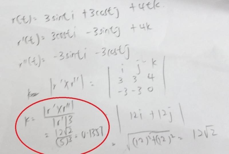

ok , i have tried in another way , but i didnt get the ans though ...
here's my ans , i gt k = 0.1357
instead of 4/25

bump , what's wrong with my working ?
Your work for r' x r'' is wrong. Your determinant for the cross product assumes that r'(t) is 3i + 3j + 4k, and that r''(t) is -3i - 3j + 0k. Neither of these is correct.
after correction , my ans is 12i -12j -18k , so magnitude = 6sqrt (17) ,
No If this is for r'(t) X r''(t), it's wrong. In the attachment in post #20, you have the calculations for r'(t) and r''(t) correct, but the determinant leaves out all of the sin(t) and cos(t) factors.
The determinant for calculating r'(t) x r''(t) should look like this:
##\begin{vmatrix} \hat{i} & \hat{j} & \hat{k} \\ 3\cos(t) & -3\sin(t) & 4 \\ -3\sin(t) & -3\cos(t) & 0 \end{vmatrix}##
