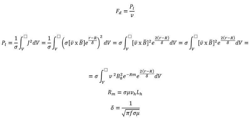

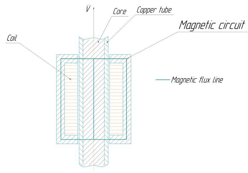

I try to calculate brake force for primitive eddy current brake, but I have problem with determining the frequency (skin depth) and characteristic length (magnetic Reynolds number)
Hello everyone, I try to calculate brake force for primitive eddy current brake, but I have problem with determining the frequency (skin depth) and characteristic length (magnetic Reynolds number). I attach the equations and a scheme of the model.
Typeset equations for eddy current braking force: F_d = P_l / v, P_l as the integral over volume of J squared divided by sigma, R_m = sigma mu v_h L_h, and skin depth delta = 1 / sqrt(pi f sigma mu).
Cross-section schematic of an electromagnetic device with a central core passing through a coil, surrounded by a copper tube and a blue-outlined magnetic circuit with a flux line; labels read Core, Copper tube, Coil, Magnetic circuit, Magnetic flux line, and an arrow marked V.
